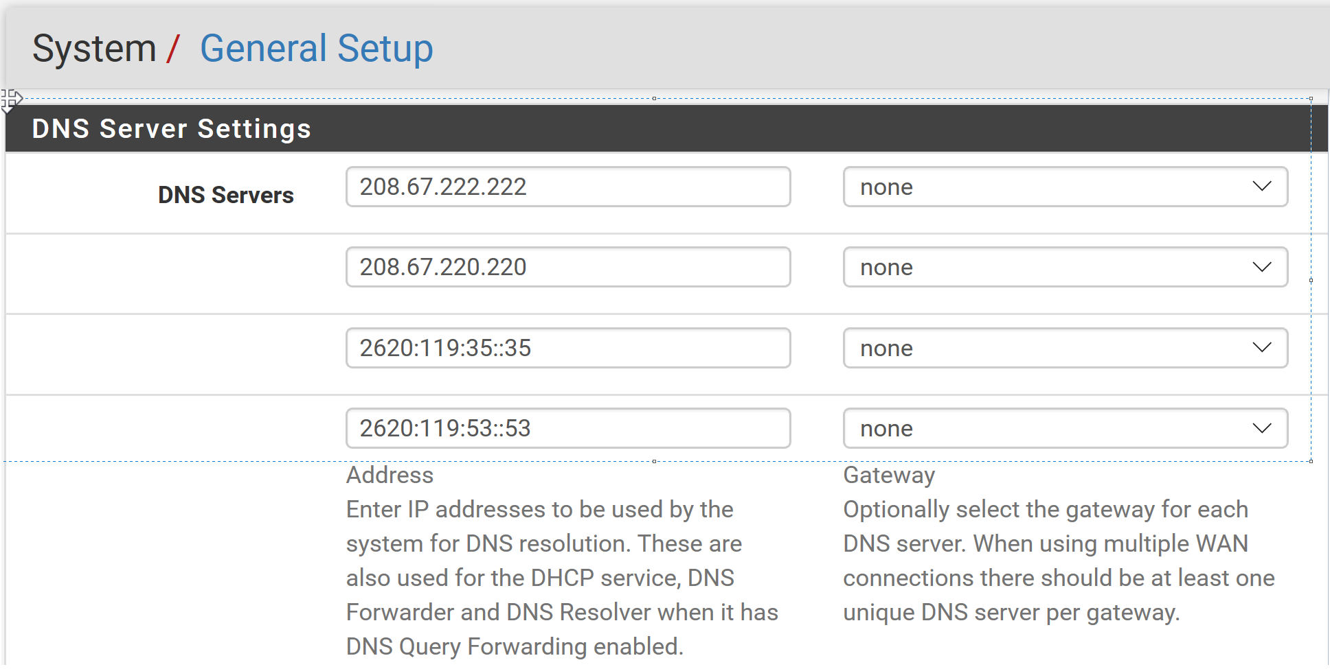

These settings are used to instruct the pfsense to use these DNS settings, NOT the clients.
It's actually a good idea to make the pfsense use other DNS servers than the pihole, It will ensure the pfsense can always get to the internet, regardless of pihole.

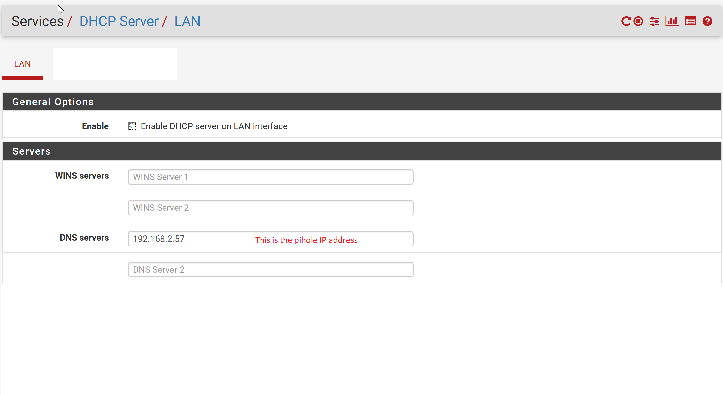

In order to get the clients to use the pihole, you need to modify the pfsense DHCP settings:
Don't enter a DNS Server 2 value, unless you have two pihole's!
I have it running like this, works like a charm....

  • If you have an IPv6 address on the WAN interface, also enter the IPv6 addresses on System>General Setup>DNS Server Settings for the DNS servers you choose. It will make the pfsense more responsive. I had to refresh the home screen to get the update status of the system, this problem disappeared when adding the IPv6 entries. The package manager also responded better.
  • In System>General Setup>DNS Server Settings, use unfiltered DNS servers, I use openDNS.
  • Install the package Service Watchdog and configure it to monitor the DHCP service.
