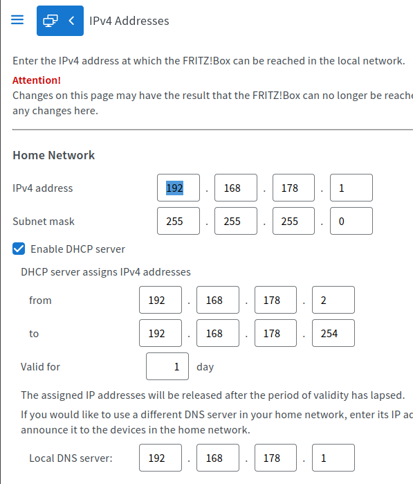

1. Local Network setting

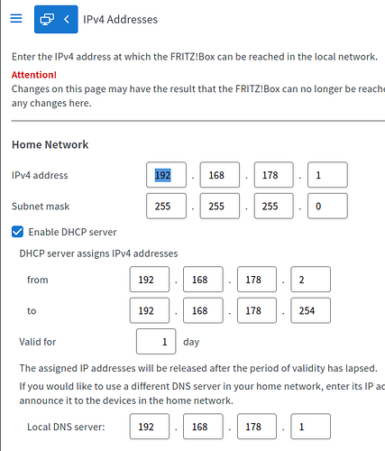

1.1 IPv4 Settings
192.168.178.130 is my pihole. First issue I'm facing: Setting my local DNS server to my gateway, as in screenshot, will cause that I can't access local devices via my local DNS, for example klinke.eisbein for the pi-hole container. This happens mainly on my mobile android device. Local DNS works currently for my pc (192.168.178.102/103) even though it's not connected. If I set 192.168.178.130, so my pi-hole, the fallback to public DNS servers does not work, which would be crucial feature of my home network.

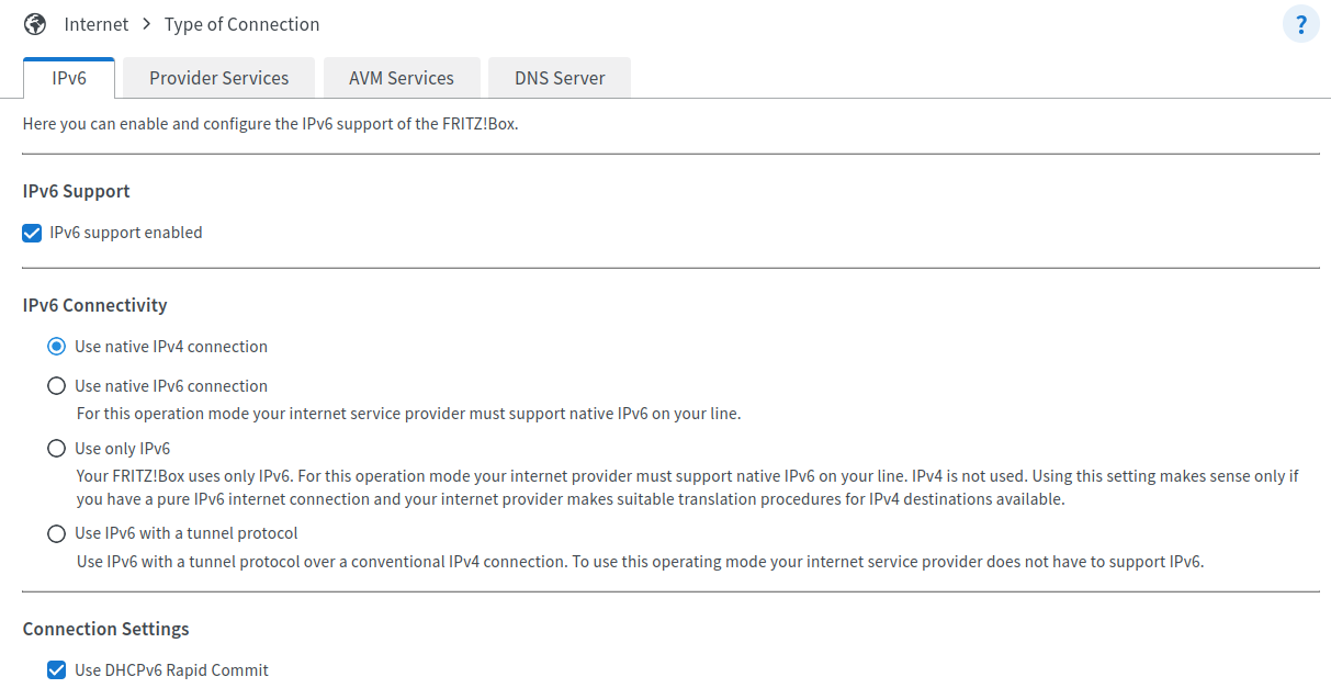

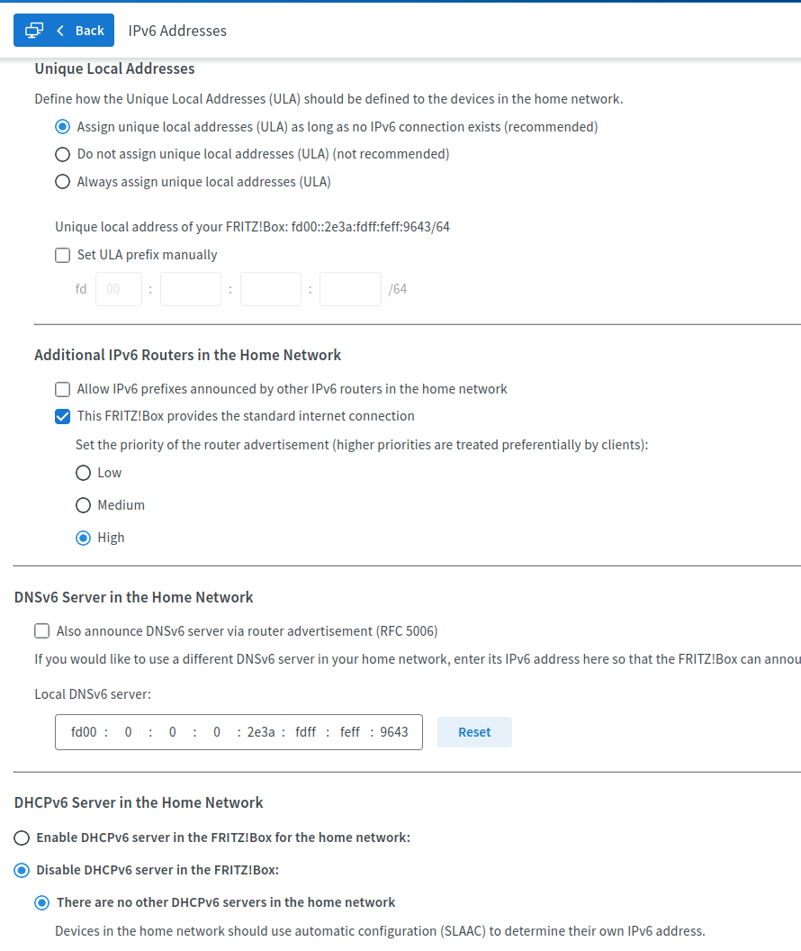

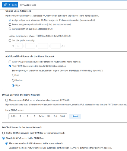

1.2. IPv6 Setting:
Here i just followed the guide. I have the feeling, this could be some root error - since my internet provider offers me IPv6. (I'm not too much into network, hope you get what I mean)
2. "Internet" Settings
2.1 IPv6 support
I wanted to disable IPv6 to make my life easier. However, this caused problems. Either no internet connection or no client connection with pi-hole.

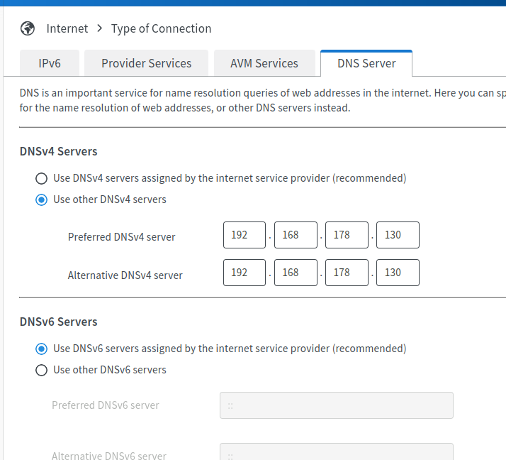

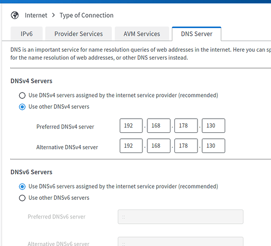

2.2 DNS settings
I guess that should be clear...

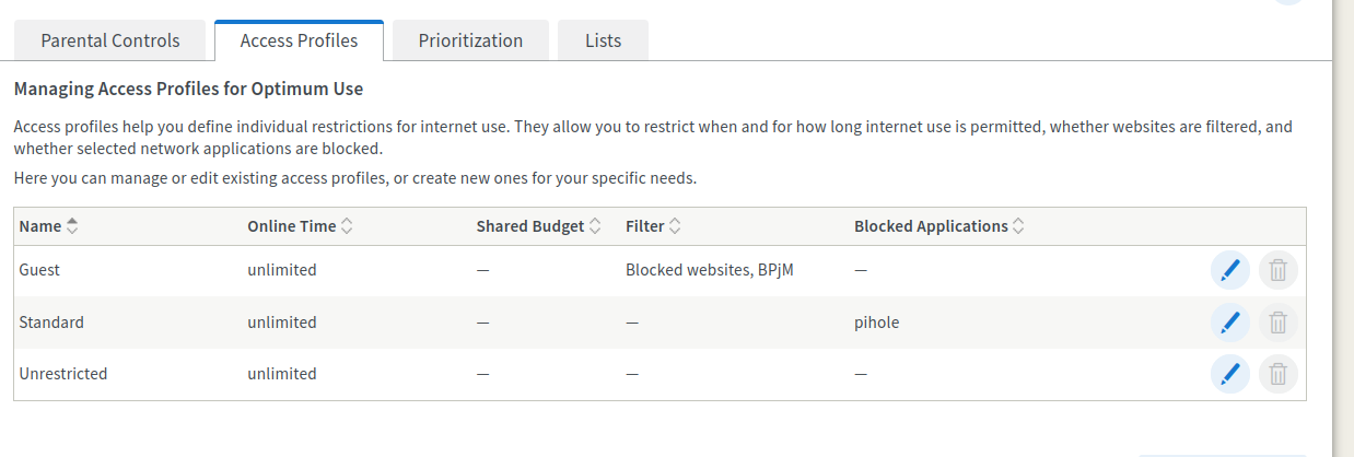

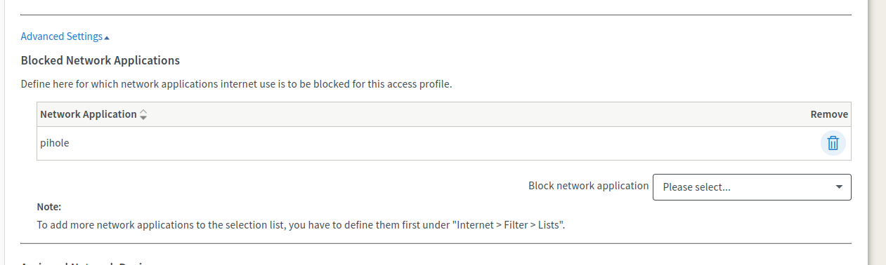

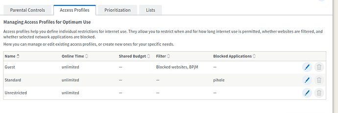

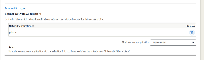

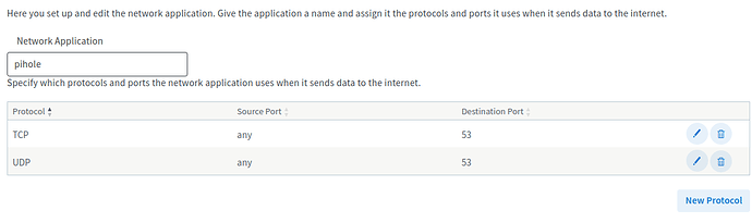

2.3 Parental control/filter to force using pihole
(images see reply)
I followed the guide to setup a filter, that forces clients to use pi-hole (?). Pi-holes access profile is unrestricted, all others use "standard" which has "blocked" udp and tcp.
I focused the same issue from beginning. With the current settings, it works better, so for a longer timerange, however not persistent.

In your current configuration, your clients never use Pi-hole, but rather your router at 192.168.178.1 as local DNS server, and your router then forwards them either to your Pi-hole's IPv4 address or to your ISP's DNS server IPv6 addresses.
You should change your router's local DNS server as distributed via DHCP (your 1.1.) to your Pi-hole host machine's 192.168.178.130, and leave the router's IPv4 and IPv6 upstreams with your ISP (your 2.2. Internet|Type of Connection| DNS Server).
Was always messing around with the local DNS setting, not the ISP part. Tried it for a few (3) days and seems to work quite nice :slight_smile: THANKS!
