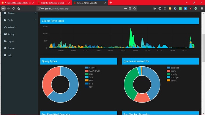

@drewski could you post screenshots of your d-wrt settings? Do you use its DHCP server for both IPv4 and IPv6?
