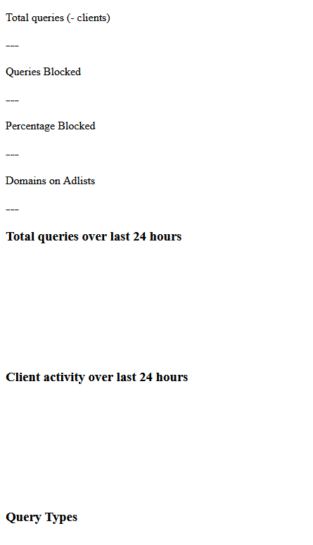

Good afternoon all,
Went to go check the admin interface on my pihole and this is what it displays, it used to work perfectly, I'm not sure why its randomly started doing this.
I also updated PiHole to see if it would fix it, but it still displays this:
Anyone have any tips on how to fix this? Pihole still actually works, just the admin interface doesn't for some reason.
I'm runing PiHole on an RPi4B and on DietPi as my distro
Thanks

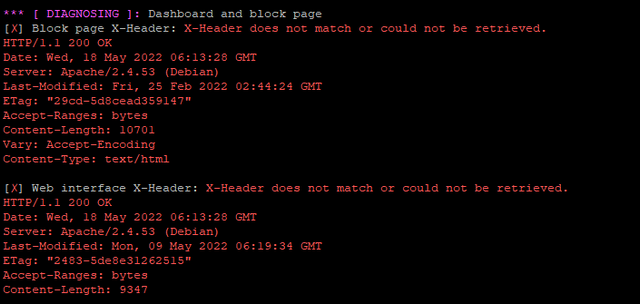

Please follow our help template. In particular, we need a debug token.
This is what pihole status returns
[✓] FTL is listening on port 53
[✓] UDP (IPv4)
[✓] TCP (IPv4)
[✓] UDP (IPv6)
[✓] TCP (IPv6)
This is the Token it gave:
https://tricorder.pi-hole.net/0gxpv3PC/
I think it showed an issue up with apache at the start of the pihole -d command but it seems for some reason it hasn't saved what it reported in the log file?
EDIT: Says Apache is using port 80
Also throws up this
You are running Apache as a webserver, in additon to (or instead of) Pi-hole's lighttpd:
[✗] tcp:0.0.0.0:80 is in use by apache2 (https://docs.pi-hole.net/main/prerequisites/#ports)
You have to resolve that conflict, either by disabling Apache, or by moving Apache or lighttpd to a different port (edit: e.g. via /etc/lighttpd/external.conf).

EDIT: Moved lighttpd to port 8080 now the web interface is working correctly.
