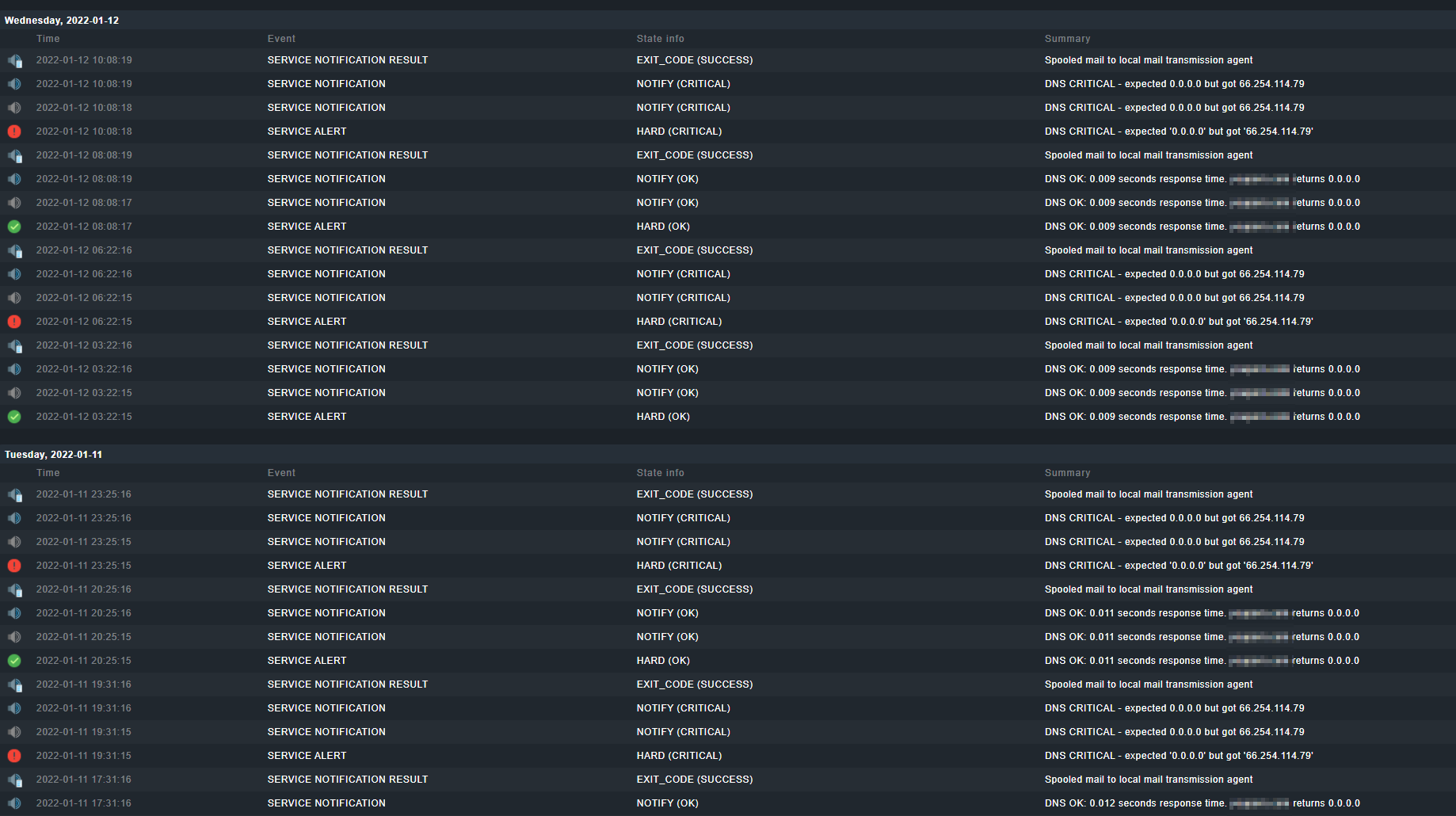

i was wondering why sometimes some pages was reachable, so i decided to include a monitoring check for the pihole.
this check, make a dns lookup with the pihole dns server.
the problem is, that the adlist is not loaded or used every time, but i see no reason for it.
In the querie log, i see, that the pihole use external dns servers for resolving it, but normaly he should use the adlist or not?

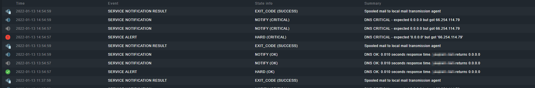

in my first post in the first picture you can see in the monitoring events, that sometimes it is working.

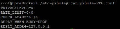

i changed the configuration to:
The problem still existing.
