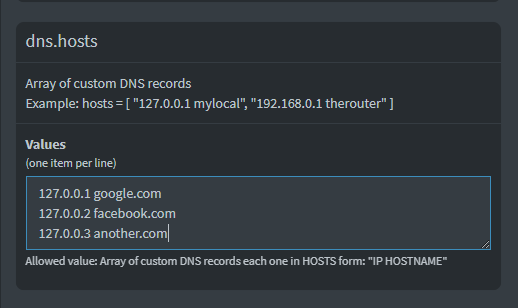

Also if you want a way of just pasting in a list on the web interface - toggle the "Expert" mode, and then go to Settings -> All Settings -> DNS Server -> dns.hosts
and you can just paste them in and save
This could be great. And I can see/édit in ui admin ?
