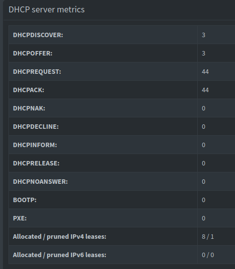

As a workaround i set up another dnsmasq container for tftp&pxe.
DHCP BOOTP&PXE metrics shows 0 even if some client boots from the new tftp container.
TFTP dnsmasq 2.90
