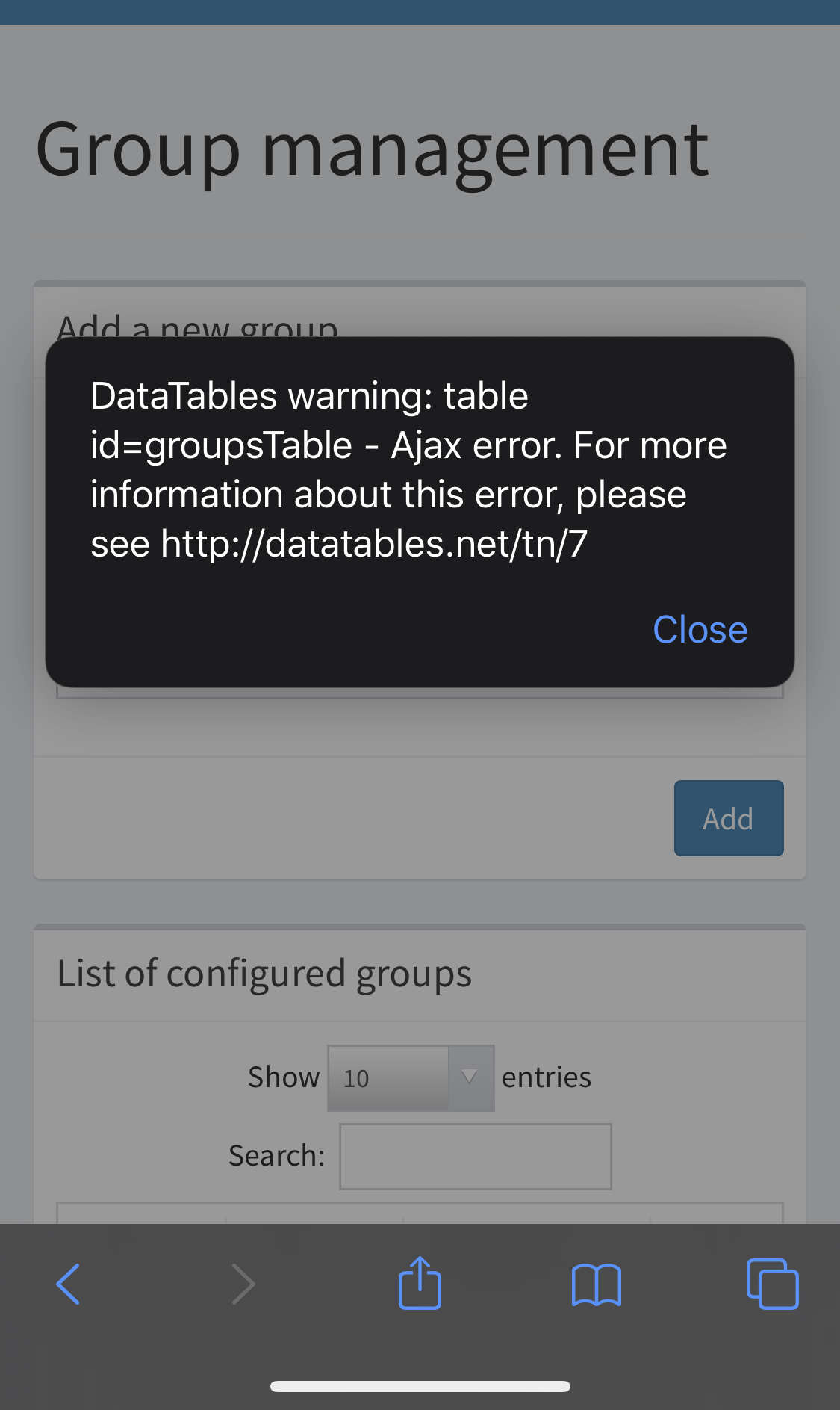

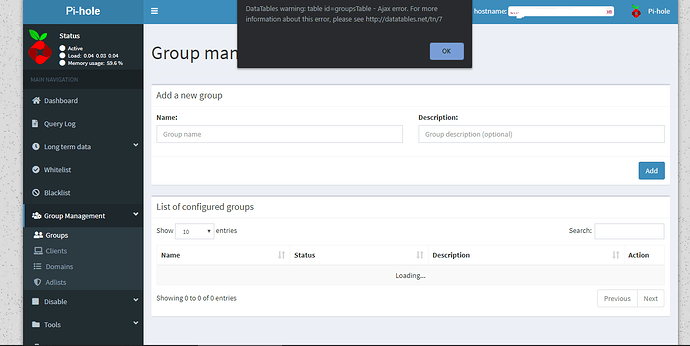

Pihole 5 upgrade error : DataTables warning: table id=groupsTable - Ajax error. For more information about this error
my pihole is running from my vps/vpn server,, after upgrading from v4.4 I got this error..I cant add any group/client blacklist/whitelist,,thankss
Please either clear the cache on your browser or force reload the page with ctrl+F5, that should stop the error
hmm same problem.Even trying on my phone browser .
