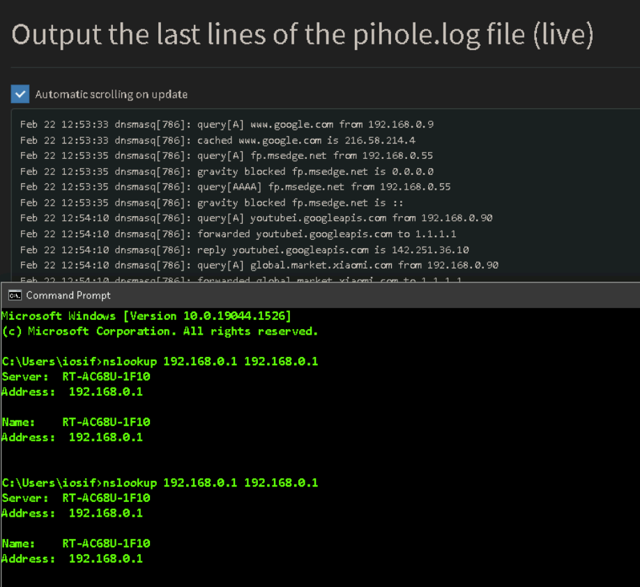

It seems that PiHole didn't displayed anything related to this:
Both commands were issued from 192.168.0.55

It could be that the capitals thwarted our earlier grep attempts.
Could you try to run
zgrep RT-AC68U-1F10 -m 1 -B2 /var/log/pihole.log*
Also, if you rerun the top-clients and top-domains calls, would they still return your router's IP and its name as top entries?
