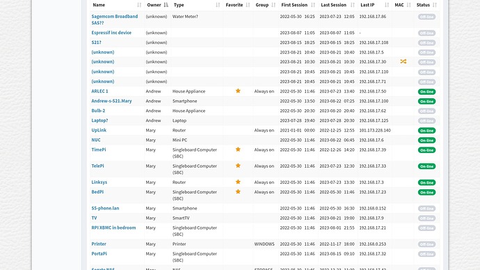

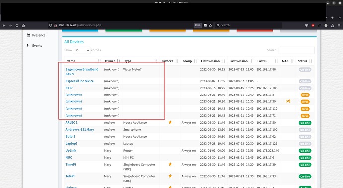

I am seeing these MAC addresses in/on my list often.
The top one I named. Searching their company name and what they make, I can believe/suspect that is what it is.
But what sort of concerns me is HOW ARE THEY GETTING CONNECTED?
My WiFi has a good password so I don't understand what this is telling me.
I have (now) taken extra steps and basically if those MAC addresses DO CONNECT, all/any packets from them are dropped.
But could someone help me understand why/how they are getting into my network's list?
Thanks in advance.

Yes, I've been into Tools/Network
and that's where I theorised the water meter for that MAC address.
I guess that isn't the right word at this point as it is more a hypothesis than a theory.
My mobile phone does have such a feature and I believe I've turned it off.
To test myself I looked at the page and connected to my network. Nothing indicated it was connected or had any activities on the unknown MAC address - but then there is the possible problem they are still flagged a new
so that blocks the showing of online
Another interesting question/observation is the one with the squiggly =
sign which is indicative of a random MAC when I open the tools/network
page.
How is that determined?
For the sake of trying to help, I've cleared all the new devices so they aren't new
anymore.
I connected my smart phone to my network.
This is what I see.
You can see the phone listed.
No new/listed activity on any of the other unknown devices. Only the phone's.
