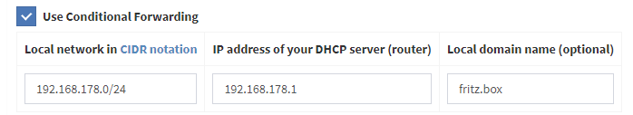

Looking at that Pi-hole settings screenshot, you configured Pi-hole correctly for conditional forwarding.
I need to have the local hostnames on the Pi where I am running Pi-hole.
It works flawlessly on all my other machines, but not on the Pi with the Pi-hole. As far as I understood it, this is "normal" unless you enable conditional forwarding in Pi-hole. Which perfectly makes sense to me. The Pi-hole should pass local hostnames to be resolved in my router.

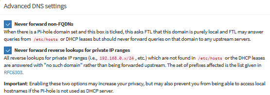

fritz.box is a fully qualified domain name (FQDN), whereas philips-hue-br2 isn't.
You may have to untick Never forward non-FQDNs under Advanced DNS settings from Settings| DNS.
If your router isn't your Pi-hole's only upstream, you may have to define respective Local DNS records for your plain hostnames instead.

EDIT: Ow and I still have " Never forward non-FQDN" enabled as the queries going out will be a FQDN when the DNS suffix/domain_name is added:
