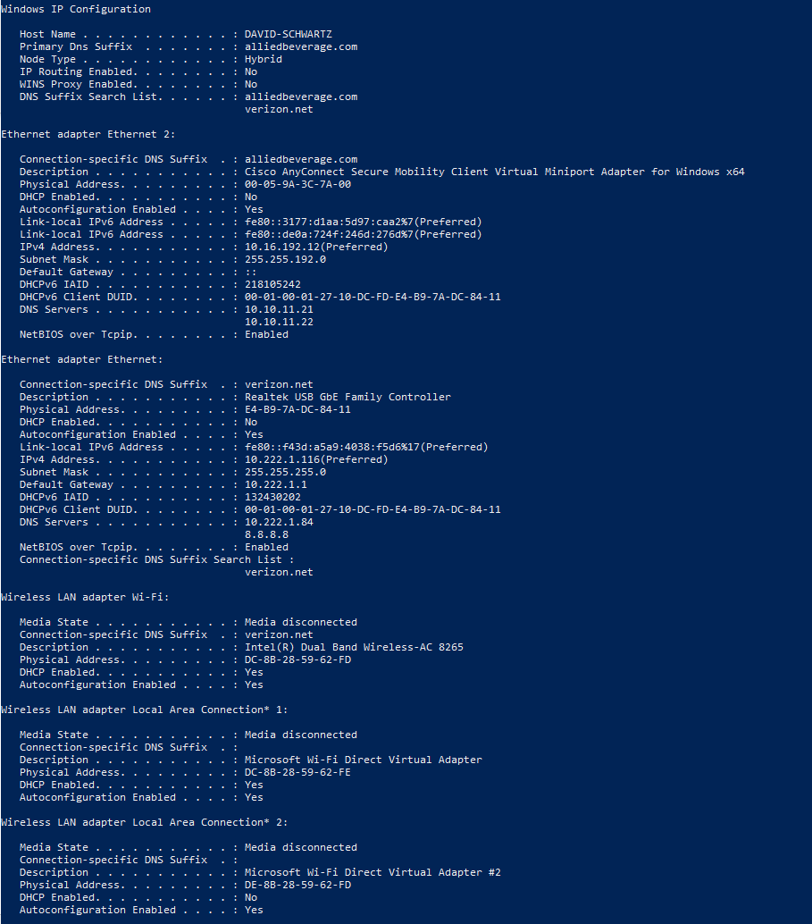

Check your Win10 machine if that's the case by inspecting the DNS server section of the following command (run on your Win10 box):
ipconfig /all
Here is what my Win10 PC reports:
If that is too hard to read, here is txt version:

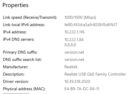

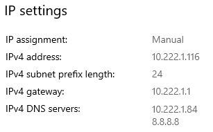

Here is snapshot of my Win10 PC IP settings
Here are properties shown just below my Win10 PC IP Settings

Your Windows machine is part of different subnets and has an overall total of 4 DNS server to choose from:
Your client would be free to by-pass your Pi-hole at 10.222.1.84 by any of the other DNS servers.
It will always do so for traffic that flows through your Cisco AnyConnect network adapter.
For the Realtek adapter, your client will by-pass Pi-hole via 8.8.8.8 at times.
Pi-hole has to be your sole DNS server, at least for your Realtek adapter connecting to your home network.
You should remove 8.8.8.8 from your cllient configuration.
