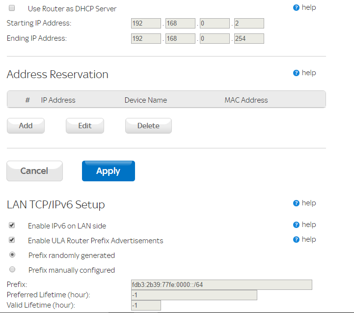

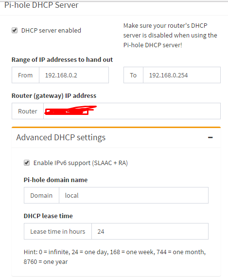

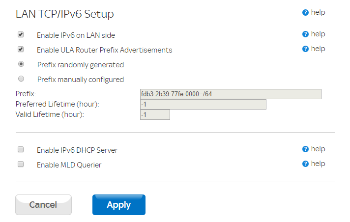

I am using Pi-Hole as a DHCP server, and have it disabled on my ISP provided server.
The DNS setting is locked by my ISP and so i cannot maually set it within my router
