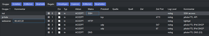

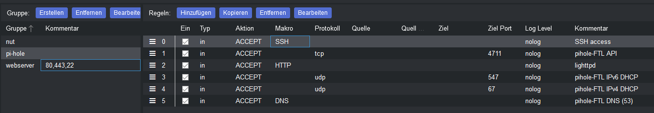

Found the problem and solution for Proxmox:
Check your f***ing firewall :face_with_spiral_eyes:
In Proxmox (if you use a firewall — and I recommend that) set the firewall for the Pi-Hole Container like this:
Forget to set the SSH rule active. Damn that's embarrassing.
