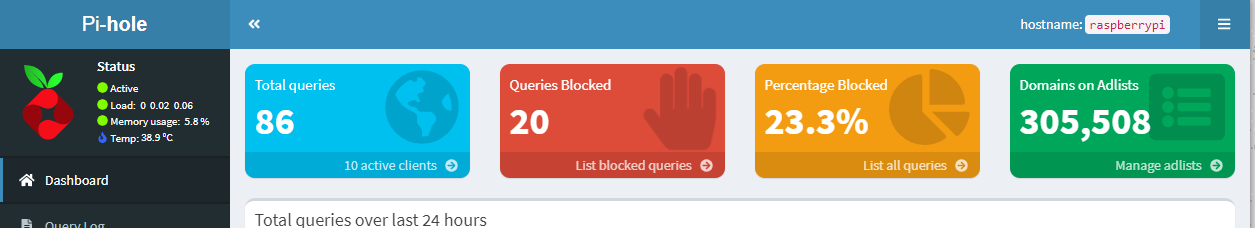

rpi4 - Previously, my pi-hole seemed active, like it was constantly blocking. Now it's only working in fits and starts. Total queries and queries blocked is exceptionally low for a blocklist of like 300k.

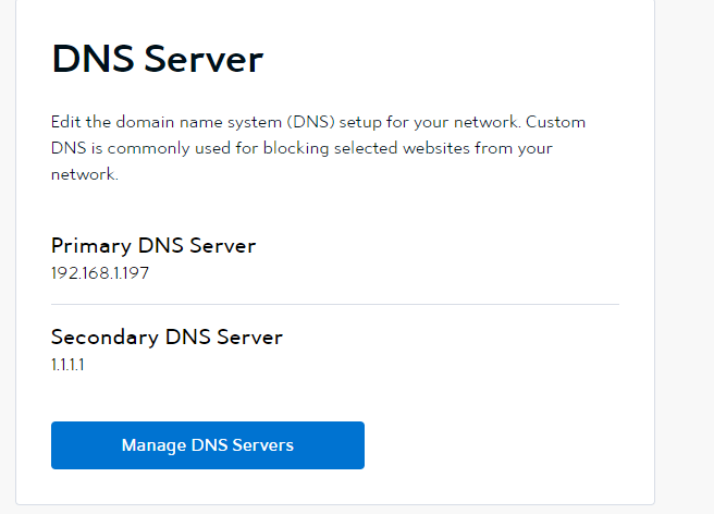

The log reveals that the router is the DHCP server and is giving itself (the router's IP) to clients to use as the DNS server, instead of giving Pi-hole's IP. To fix this, go into your router's settings, find the DHCP/LAN section and edit the DNS servers so that Pi-hole's IP is being used. Savr the changes, then take each device on your network and bounce it off and back on the network to pick up the new settings.
So, I am doing that.
Queries are still low.
Remove the secondary DNS server, because any device using it will be bypassing Pi-hole. Don't forget to take your devices and computers off and back on the network to pick up the DNS settings.

Starting with that first nslookup - it says server cant find pi.hole. Server is 8.8.8.8. Issue with the secondary DNS thing is my router is one of the Spectrum routers and I have to put a 2nd DNS
So it's bypassing Pi-hole and using Google's public DNS. Since that didn't come from the router (which has Cloudflare as a secondary), perhaps it's adding Google itself. I know some Android smartphones will do this, seemingly with no way to disable it. You need to find out where that Google entry is coming from and eliminate the source, if possible, or else that device will always be able to bypass Pi-hole.
Another possibility, for anyone seeing this later on, is some routers have a firewall capability which lets you redirect traffic, so you could arrange that all traffic to 8.8.8.8 is sent to Pi-hole, so even if it tried to bypass it, it ends up going to Pi-hole anyway. But it sounds like your router cannot do that. Another option, instead of redirecting it is to simply block it. At least then nothing can easily work around Pi-hole. Again, it needs a firewall feature on the router which supports this, but this is a bit more common than the previously mentioned redirection option.
As for the Spectrum router, are you able to enter the Pi-hole IP for both entries? If you're forced to have a non-Pi-hole entry then clients will always have a server which bypasses Pi-hole.
Alternatively, are you able to disable the router's DHCP setting completely? If so, you could enable Pi-hole's DHCP server and use that instead. Note that it needs a little planning, depending on what you have on your network.
These awful Spectrum routers don't allow duplicate IPs or solo IPs. The entries have to differ. Is there a good secondary IP you recommend?
