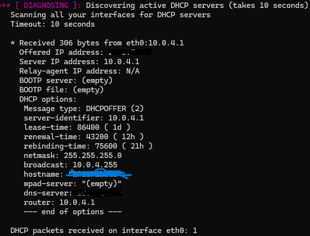

Indeed, your debug log shows that your router is distributing itself as local DNS server:
   * Received 306 bytes from eth0:10.0.4.1
     Offered IP address: 10.0.4.26
     DHCP options:
      Message type: DHCPOFFER (2)
      dns-server: 10.0.4.1
      router: 10.0.4.1
      --- end of options ---
That would suggest that you have configured your router to use Pi-hole as its upstream DNS server, as opposed to having it distribute your Pi-hole machine's IP as local DNS server.
That is a valid configuration, but as your router aggregates your network's DNS traffic, becoming Pi-hole's only client, you won't be able to attribute DNS requests to individual clients.
If your router supports it, it would be preferred if you'd configure it to tell its clients to use Pi-hole directly.

I have had a poke around in my router settings, it seems there is a further section under each local network under primary DNS under IPv4DHCP server. So I have added pihole IP here too, and to the guest network and my IOT network.
Is this now preferable?
I am not sure on this.
This seems to be the major issue. Two of the three onedrive profiles I back up seem to constantly sync, I don't know why. I can't solve yet, but if I pause them, network traffic drops significantly, with DNS requests dropping from 3.5k per 10 mins to 300 or so. I can mitigate this a bit by only have the onedrive profiles update once a day, when again network dns requests will rocket. I need to work out why these two profiles are different so I can fix it.
Based on above DHCPOFFER, you've succeeded in having your router's DHCP server announce your Pi-hole machine's IPv4 address as local DNS server.
As your router has link-local IPv6 connectivity, you should also verify its IPv6 DNS configuration options (which potentially would be a bunch of options labeled with one or more of NDP/SLAAC/RA and perhaps DHCPv6).
Your debug log shows that at least the Pi-hole host machine currently isn't aware of any IPv6 DNS server addresses (which is absolutely ok, as serving DNS via IPv4 is sufficient).
