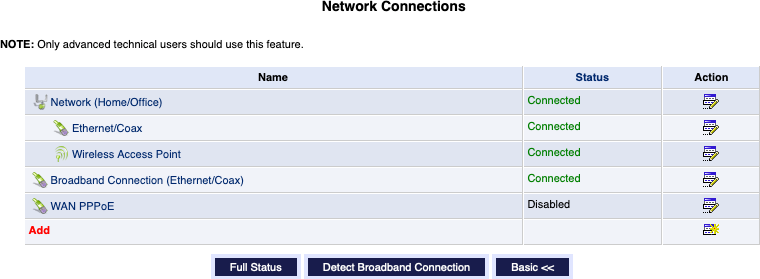

In any case, when changing my router's DHCP settings I was not sure which network connection to edit. The router web admin page lists several:

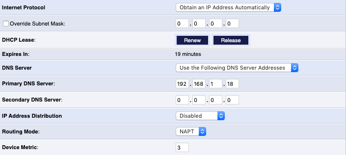

Originally, I edited the one listed as "Broadband Connection (Ethernet/Coax)":
That seems to work for a few days, but then stopped. After that, I tried applying the same DCHP settings to the network connection listed as "Network(Home/Office)". But that didn't seem to have any effect. I'm not sure which network connection I should've edited DCHP on?

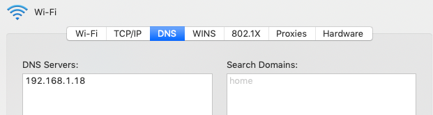

Even if I many set my computer's wi-fi DNS server back to the Pi Hole's address it still isn't working.

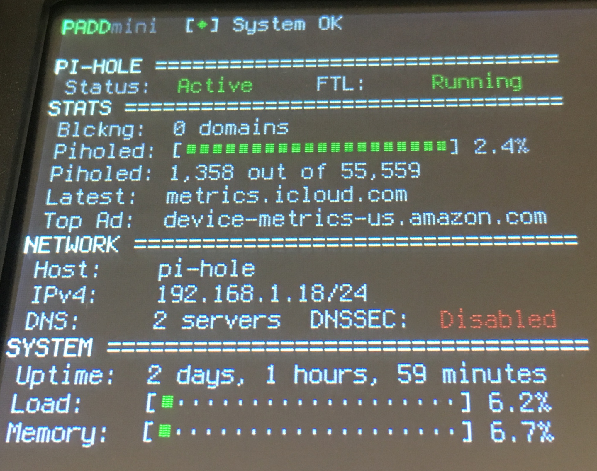

I have no idea why it stopped working. Here's a screen-shot of the display:
qwxm6pddey
Your debug log shows that your Pi-Hole is listening on the eth0 interface at the address below.
   192.168.1.18/24 matches the IP found in /etc/pihole/setupVars.conf
But, further down in the debug log you see that your gravity list is empty. This corresponds with your screen shot showing "Blckng: 0 domains".
-rw-r--r-- 1 root root 0 Nov 24 04:50 /etc/pihole/gravity.list
The solution is to update gravity - from the terminal pihole -g or from web admin interface (tools > update gravity). This will reload your subscribed block lists and populate the gravity list. With your subscribed blocklists, you should see about 137K domains blocked.
