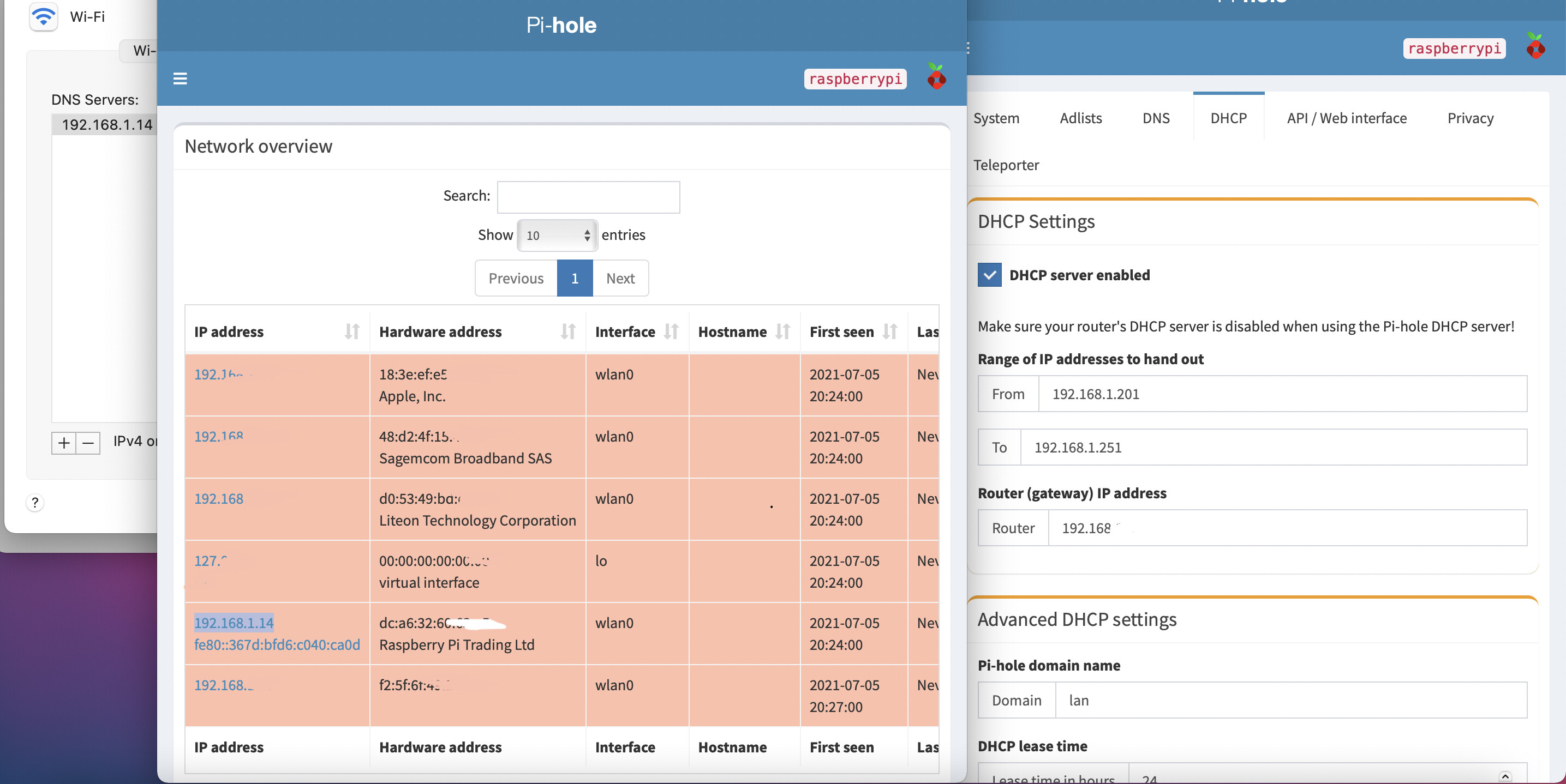

The issue I am facing:
Hi, why I have all my devices “never uses pi hole”. When I want to type rpi address in dns servers on my computer or phone internet not working and devices still got red colour on this table. Please help.
Details about my system:
raspberry pi 4 + rasbian lite
I have static ip, I turn off DHCP on router (but when I try to turn off DHCP server on router pi hole website doesn't turn on) and on DHCP on pi hole, I reinstall rasbian.
Tools > Generate Debug Log
I think this is it:
https://tricorder.pi-hole.net/k2ndcy2hip
You've configured Pi-hole to listen on eth0, but only have a wireless connection at wlan0.
[✗] No IPv4 address(es) found on the eth0 interface.
   Timeout: 10 seconds
   * Received 326 bytes from wlan0:192.168.1.1
     Offered IP address: 192.168.1.14
     Server IP address: 192.168.1.1
    PIHOLE_INTERFACE=eth0
    IPV4_ADDRESS=192.168.1.14/24
Run pihole -r and choose reconfigure to set the right interface.
thank you very much, it worked :smiley:
