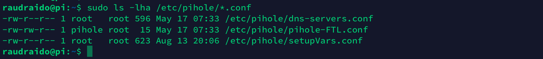

Let's look at the file permissions.
sudo ls -lha /etc/pihole/*.conf
