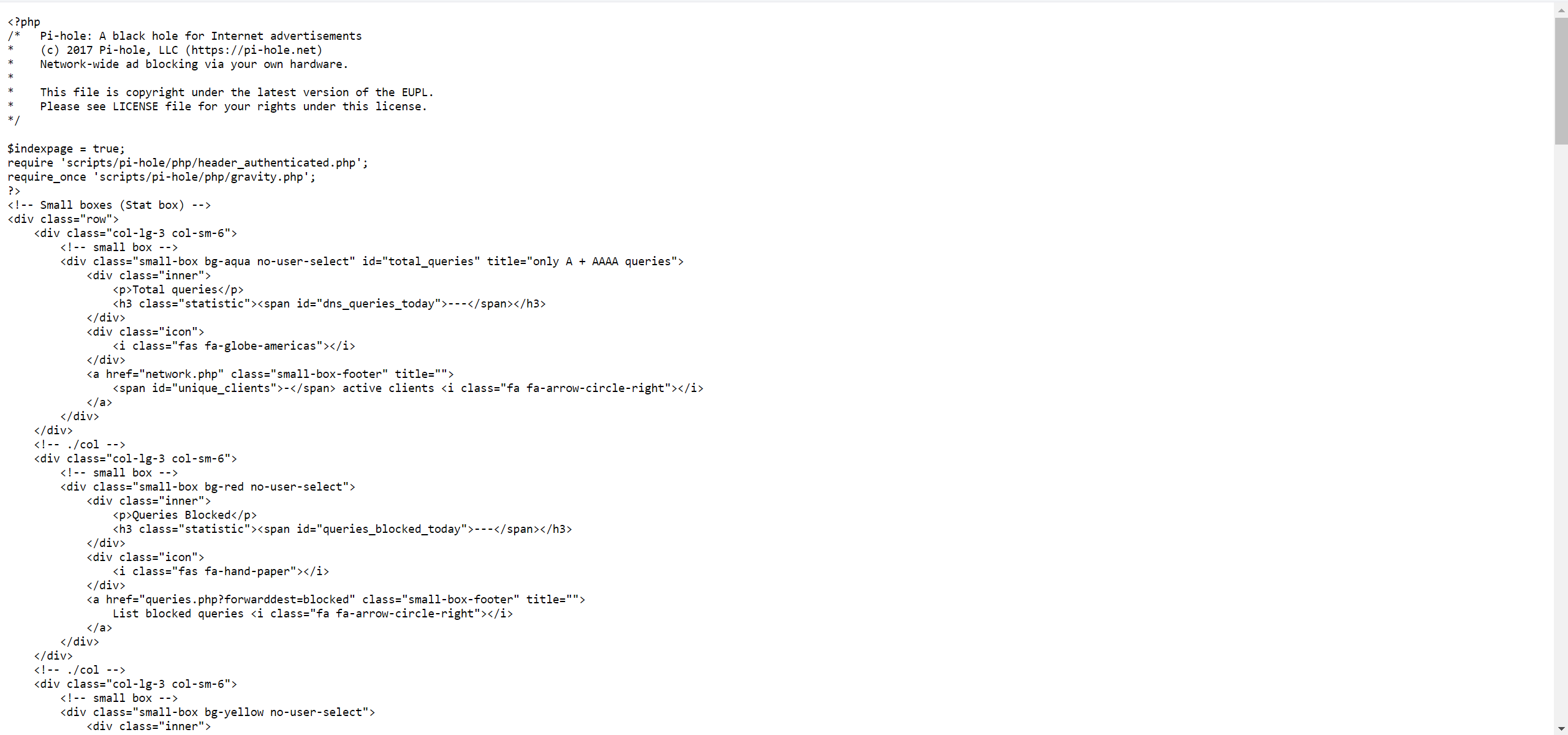

Pi-hole with white background
I can't open web interface
I can only see a white background

  2. The screenshot is showing the PHP code.
    This means your server doesn't have PHP installed or there is some module missing in PHP configuration.
    We need the log to try to understand what is missing.

this worked for me:
sudo apt purge apache2
(or change the port for it)
sudo pihole -r
(select repair only)
Hello,
I've made a clean install and now it's working fine.
