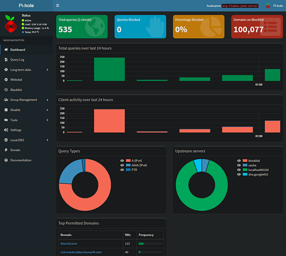

The issue I am facing:
Queries and the internet is working normally, but nothing is being blocked even if on the blacklist.
Details about my system:
Using unbound with pihole and pihole is running off ubuntu 20.10 fully up to date.
Adding unbound and IP configuration for the DNS to work on my network.
Tools > Generate Debug Log
Your nslookup command from the PC shows that Pi-hole correctly blocked the requested domain.
https://tricorder.pi-hole.net/QxuMKw18/
When I go to any site with ads or manually set a site like google to the blacklist it does not work and block those domains.
Edit: It did block those requests but only 10 queries which is far from working properly.

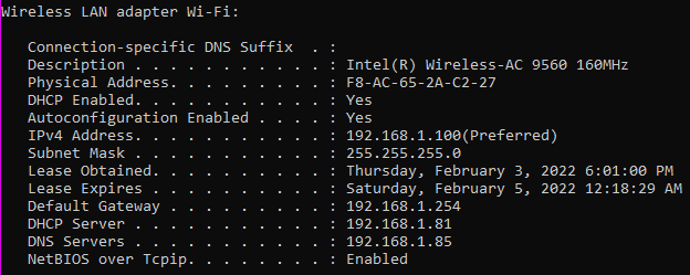

Your debug log shows two active DHCP servers, none of them distributing Pi-hole as DNS server.
Two DHCP servers on the same link may cause issues, unless they take responsibility for distinctly separate IP address ranges.
   * Received 278 bytes from wlo1:192.168.1.81
     Offered IP address: 192.168.1.107
     DHCP options:
      Message type: DHCPOFFER (2)
      lease-time: 86400 ( 1d )
      router: 192.168.1.254
      dns-server: 1.1.1.1
      dns-server: 1.0.0.1
      --- end of options ---
A DHCP client that would have acquired their lease via the above server at 192.168.1.81 would always by-pass Pi-hole.via 1.1.1.1 or 1.0.0.1.

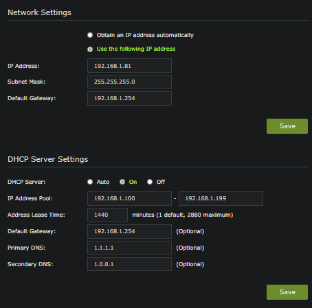

I appreciate you trying to help in that way. Here's how the internet is configured. I am using my neighbor's internet (with permission), I have a repeater broadcasting into my house, I have Pi-hole running on my laptop and using it as a server, then the internet is going to my PC. The main router is so old and locked down that you cannot set a DNS and it uses the default one set by the isp. On my extender, I can change the DNS on it but I choose not to because if I want to not use Pi-hole on a specific device and my neighbor's devices do sometimes run off my extender (whichever is closest to the device). I have it set up where they are not being touched while I have my own bubble of my setup. This is why I have the DNS' set up this way.
Despite the hassle I have to do for per-device configuration it is configured to not affect them no matter what. That's why.
I also cannot change how the extender connects to the main router too much because of how the router is I have to have things configured in a different way for me to get internet without IP issues, or else clients will not get a working IP address and even if set to static on the client it will still not work.
Here's how it is configured (this is the only way I was able to get it to work)
