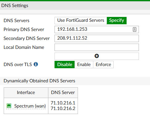

So I have my fortinet set to use 192.168.1.253 as primary DNS and fortiguard DNS as secondary. It also shows dynamically discovered DNS from Spectrum.

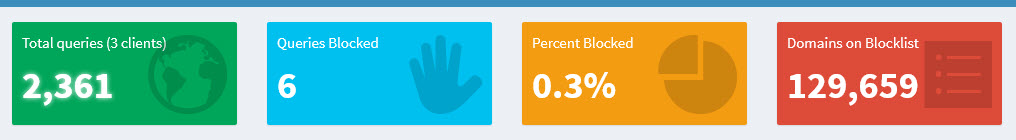

I did a log reset this morning, so those 2361 query were just from this morning. the 6 blocked were from doing the nslookup to the IP of the pihole. I believe that the Fortinet is sending the query over to the pihole, but the pihole is not blocking anything.

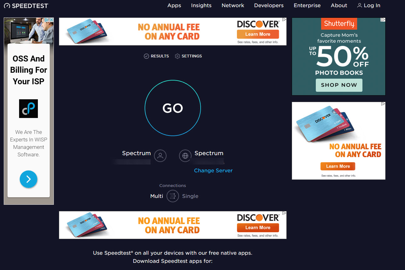

Here is what a web page that has ads looks like.. they shouldn't be there if it's blocking. Also, the block count doesn't go up. It only goes up if I do the nslookup using the domain.com 192.168.1.253 version.
Providing additional DNS server IPs apart from Pi-hole's own will allow clients to bypass Pi-hole.
Make sure that Pi-hole is your only DNS server.
Looks like it's working now. What I did was set the Fortiguard DNS as the custom DNS in Pi-Hole. I then went into WAN interface and fouind a selector for override internal DNS and turned that off. After I did that, I did a ipconfig /flushdns then a /release thien a /renew and I only see the 192.168.1.253 as my DNS server. Guessing when I did the update to the Fortinet before, it must have turned that override DNS on.. so weird..
