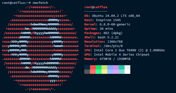

Details about my system:
What I have changed since installing Pi-hole: nothing.

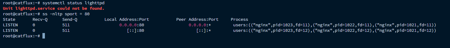

I dont even have lighttpd o,y
Pi-hole v6 doesn't need lighttpd or nginx.
You need port 80 free for pihole-FTL (the new web server).

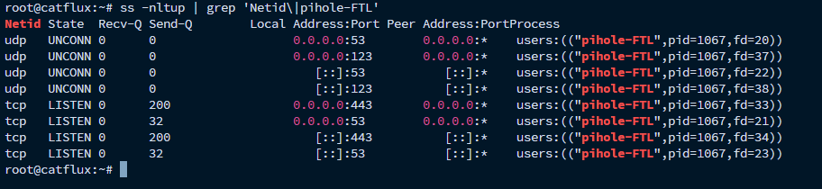

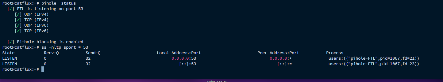

Then why is mine at 53? and still can't reach it
That last screenshot is for DNS:

And pihole-FTL does both plus some more:
$ sudo ss -nltup | grep 'Netid\|pihole-FTL'
Netid State  Recv-Q Send-Q Local Address:Port Peer Address:PortProcess
udp   UNCONN 0      0            0.0.0.0:53        0.0.0.0:*    users:(("pihole-FTL",pid=410,fd=20))
udp   UNCONN 0      0            0.0.0.0:123       0.0.0.0:*    users:(("pihole-FTL",pid=410,fd=40))
udp   UNCONN 0      0               [::]:53           [::]:*    users:(("pihole-FTL",pid=410,fd=22))
udp   UNCONN 0      0               [::]:123          [::]:*    users:(("pihole-FTL",pid=410,fd=41))
tcp   LISTEN 0      200          0.0.0.0:443       0.0.0.0:*    users:(("pihole-FTL",pid=410,fd=37))
tcp   LISTEN 0      200          0.0.0.0:80        0.0.0.0:*    users:(("pihole-FTL",pid=410,fd=35))
tcp   LISTEN 0      32           0.0.0.0:53        0.0.0.0:*    users:(("pihole-FTL",pid=410,fd=21))
tcp   LISTEN 0      200             [::]:443          [::]:*    users:(("pihole-FTL",pid=410,fd=38))
tcp   LISTEN 0      200             [::]:80           [::]:*    users:(("pihole-FTL",pid=410,fd=36))
tcp   LISTEN 0      32              [::]:53           [::]:*    users:(("pihole-FTL",pid=410,fd=23))

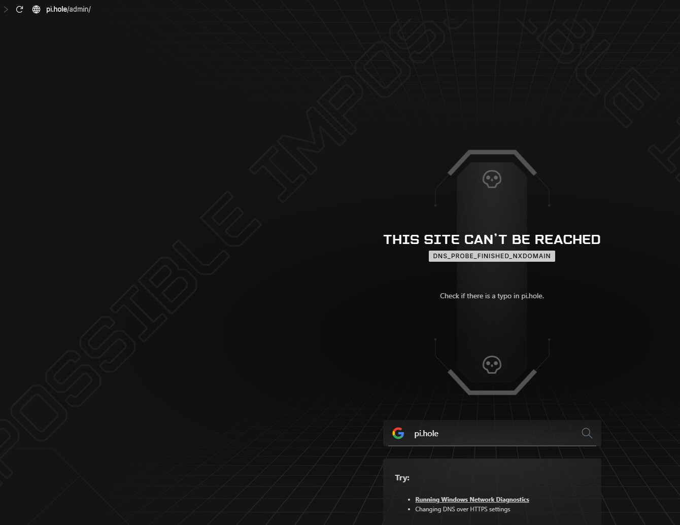

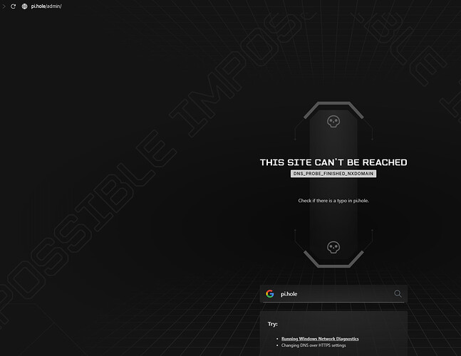

If I want to open these links this showing up every time:
https://192.168.0.248/admin/
And this is not working at all https://pi.hole/admin/

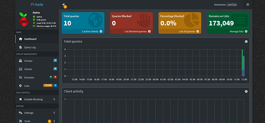

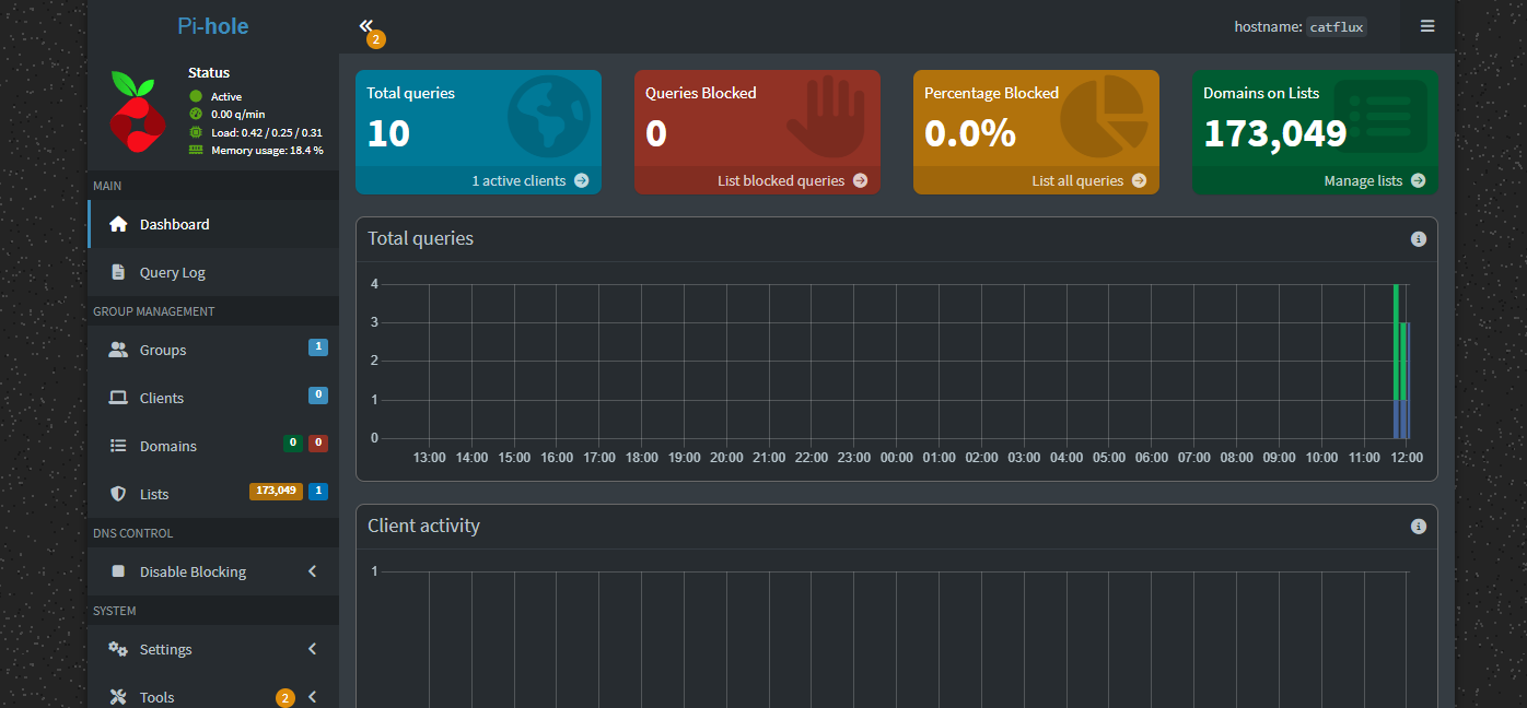

Now I can open Pi-hole
I changed some values at /etc/pihole/pihole.toml and now working.
Here is mine if someone has the same issue in future:
pihole.zip (18.4 KB)
