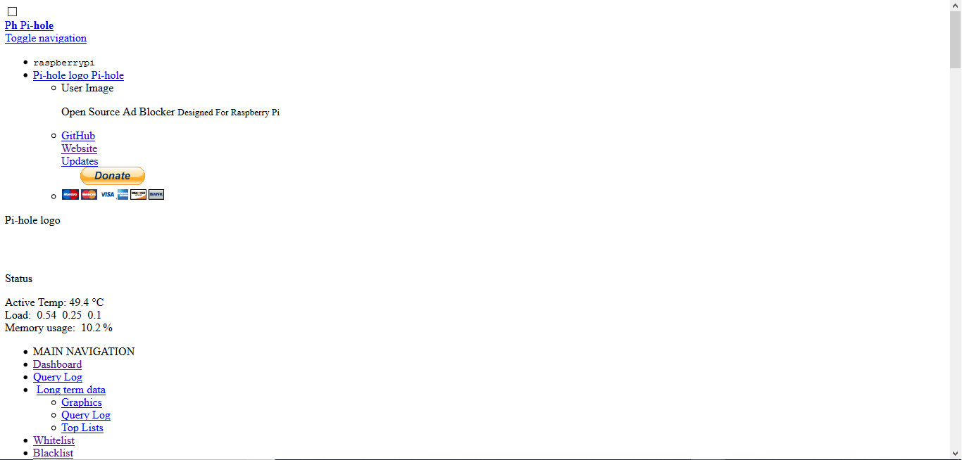

Pi-hole Web Interface not displaying correctly
Web Interface shows GUI in proper form (graphs, buttons, etc..)

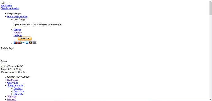

Web interface shows basic black and white text with graphs stacked vertically as you scroll through the page. (See Image)

It looks like you are on Buster, have you edited lighttpd.conf in any way?
Yes, I have edited the 404 handler to this: "/pihole/index.php" and by following the link from the website above using the second option.
That will not fix the problem. You need to change the include_shell line for the correct mime-type file. There is no need to modify the URL for the 404 handler.
See Fix lighttpd mime by RamSet · Pull Request #2816 · pi-hole/pi-hole · GitHub for the proposed fix that will be released.
I am a dummy, I realized I missed that line. Thanks for pointing it out!
