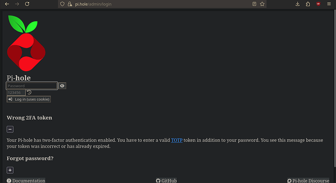

Also, after a while of waiting, the web interface stops loading and its just the login screen but all jumbled up, like it hasnt finished loading yet.
The DNS works fine as well, its literally just these two errors.

I can also send a screenshot of how the web interface looks after “loading“, i just need to wait a bit.

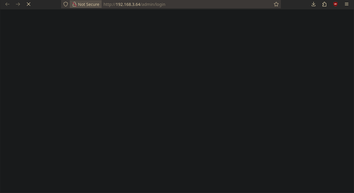

What do you see if you try to access the web interface using this URL: http://192.168.3.64/admin ?
Do you see any error messages?
This is what it shows.

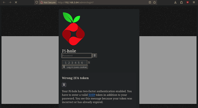

But after a while of loading, it shows this:
Entering the password also leads to a loading hell.
The screenshot isnt showing it, but there is a little message at the corner of the screen saying “Transfering data from 192.168.x.xx/pi.hole“

This is how it looks like after inputing the password:
I tried inputting it again and its just the same page. Keep in mind that these pages take a while to load.
Looking at your screenshots I can see some CSS stylesheet files were not loaded. Maybe some javascript files are also missing.
