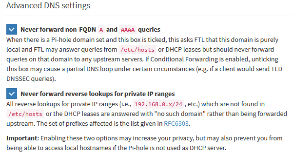

Dont use a public pihole.tld.name but use for example pihole.home.tld.name instead!
The home.tld.name is not a public one and by doing so, below features work as intended (your router most likely does something similar):
This prevents lookups for private LAN domains/hostnames that cant be answered by Pi-hole (or maybe the router if its in the loop), mistakenly being leaked/forwarded to your upstream public DNS servers.
