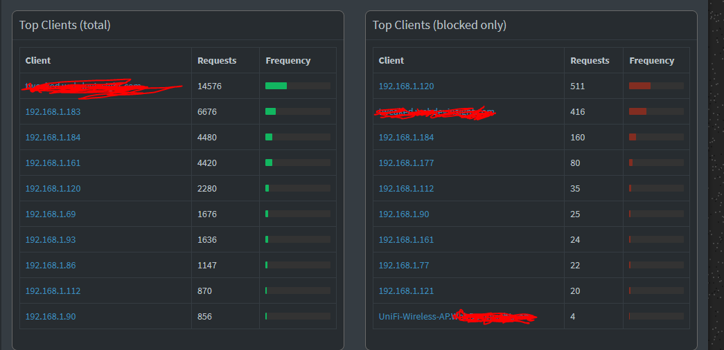

After upgrading to Pi-hole v6.1, hostnames for client devices are no longer resolving correctly in the web UI or via tools like dig or nslookup. Only IP addresses are shown, and reverse lookups result in NXDOMAIN unless the device is explicitly hardcoded via a local DNS record. Prior to the upgrade, everything resolved normally, with hostnames correctly pulled from pfSense (which handles all static DHCP assignments).
Despite hardcoding all DHCP mappings in pfSense, Pi-hole seems unable to retrieve or display these hostnames properly anymore. The new client overview page correctly detects MAC vendors, indicating some level of network awareness — but hostnames remain absent or broken.
