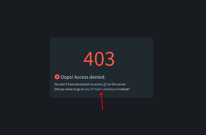

Previously, on Pi-hole v5, I could access the admin login page by using just the IP and port (e.g., http://<Pi-hole_IP>:80) when resolving my FQDN internally through my Synology NAS's built-in Nginx reverse proxy. No additional configuration was needed beyond setting the IP and port in Nginx.
After upgrading to Pi-hole v6, attempting to access http://<Pi-hole_IP>:80 results in a 403 error instead of the admin login page. The login page only loads if /admin/ is manually appended to the URL (http://<Pi-hole_IP>:80/admin/).
I am unable to configure directory paths within the Synology Nginx manager—it only allows setting an IP and port. Since this setup worked fine on v5, I am looking for a Pi-hole-side solution to make http://<Pi-hole_IP>:80 automatically serve the admin dashboard without needing to append /admin/.

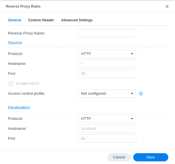

Take a look at the attached image? It shows how I set up a reverse proxy in Synology DSM using its built-in Nginx functionality. I run a homelab where I self-host multiple services, and this is the first time I've encountered an issue when reverse proxying my FQDN subdomain to a service's IP and port. Instead of displaying the intended main web service page, it returns a 404 error page that I shared a screen of in the original post. I'm not suggesting Pi-hole is to blame; that wasn't the point of my last response. After waiting 16 days without a response to my last reply, I started thinking maybe there’s no solution for this. One thing is clear, though: this probably isn’t how it’s supposed to work.

Your original post doesn't show a 404:

I just realized I made a typo that I’ve now corrected. It’s a 403 page, not a 404.
