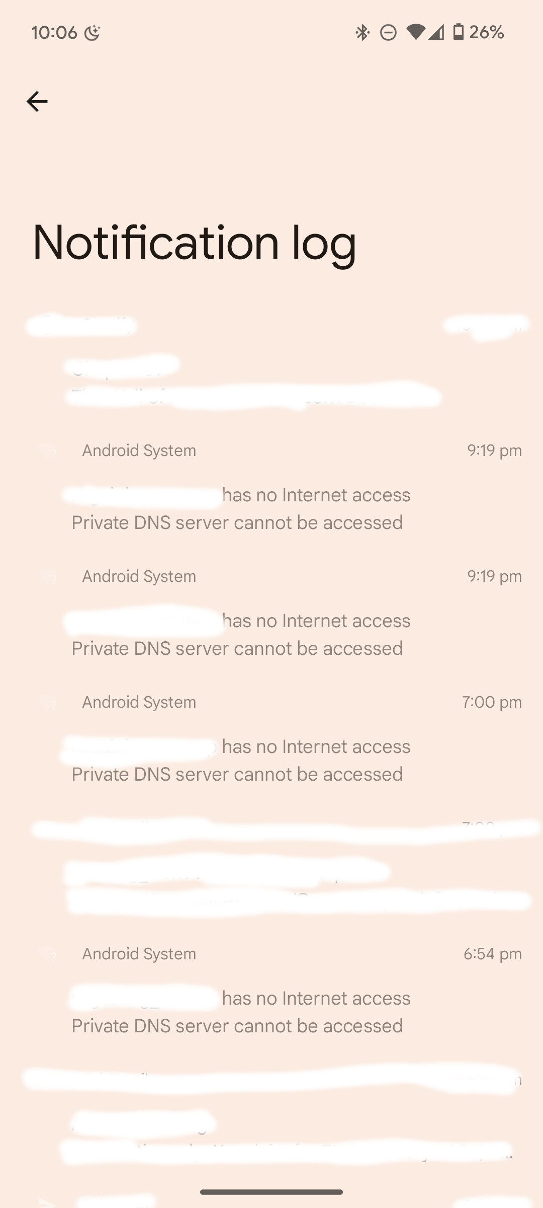

  • The two phones never lose WiFi signal, Android just decides that the network has no internet access as "Private DNS server cannot be accessed". I have 3 access points at home (complete overkill!) and have strong coverage everywhere inside the house, where this problem happens.

All the devices we regularly use on our WiFi network lose internet access every few hours with an Android message (which is associated with Private DNS, but I believe means Android can't resolve DNS to find the Private DNS server). They don't actually disconnect from the WiFi, but incorrectly report that the WiFi can't offer an internet connection.

This is all the indication I get on a current Android device
