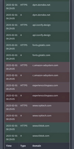

The first attached image is the list of Domains which were resolved, which I verified are the same in both Pi-hole v5 & v6 beta.

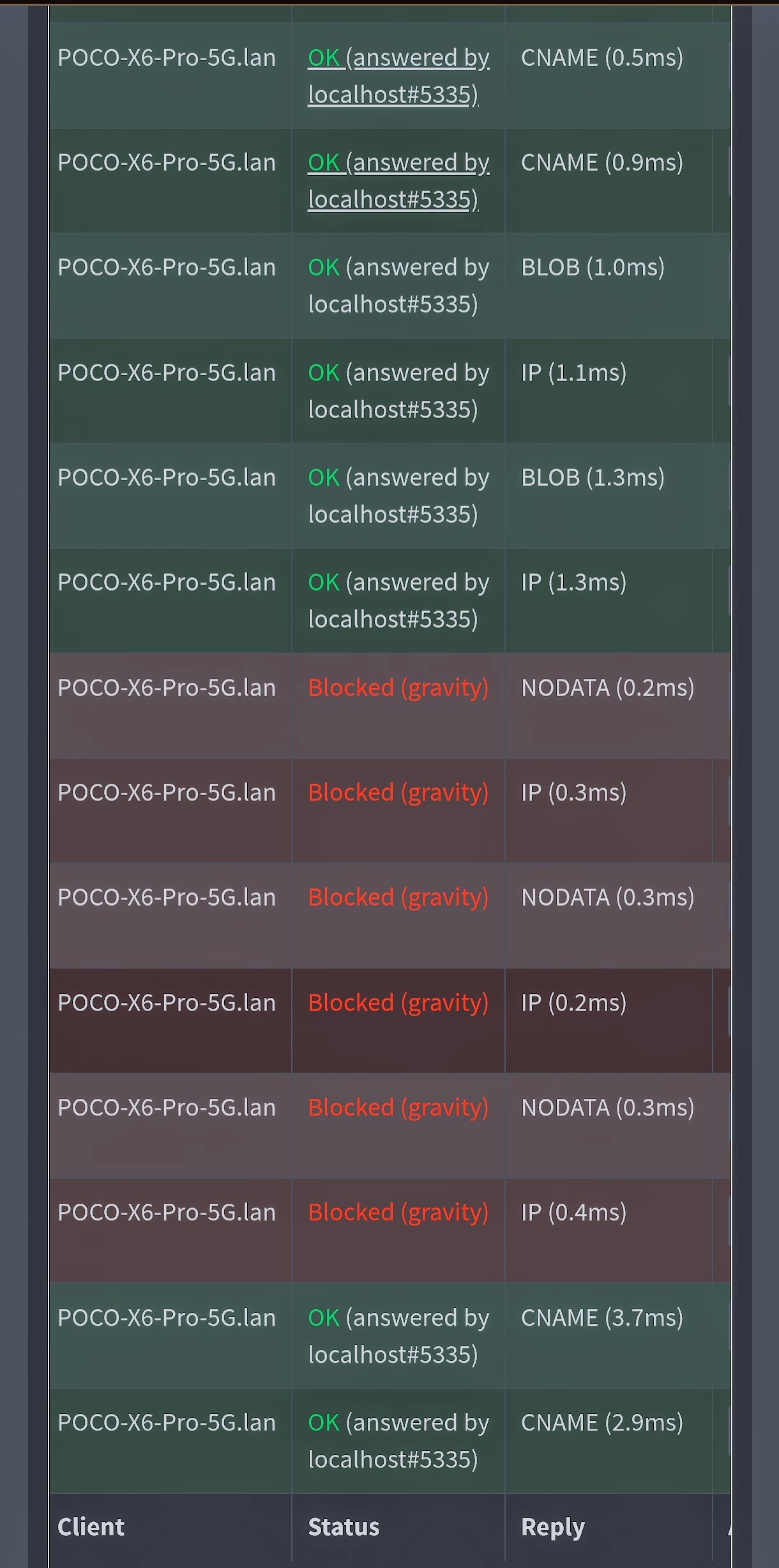

The second image is the time (in brackets) for Pi-hole v5 to resolve the domains.

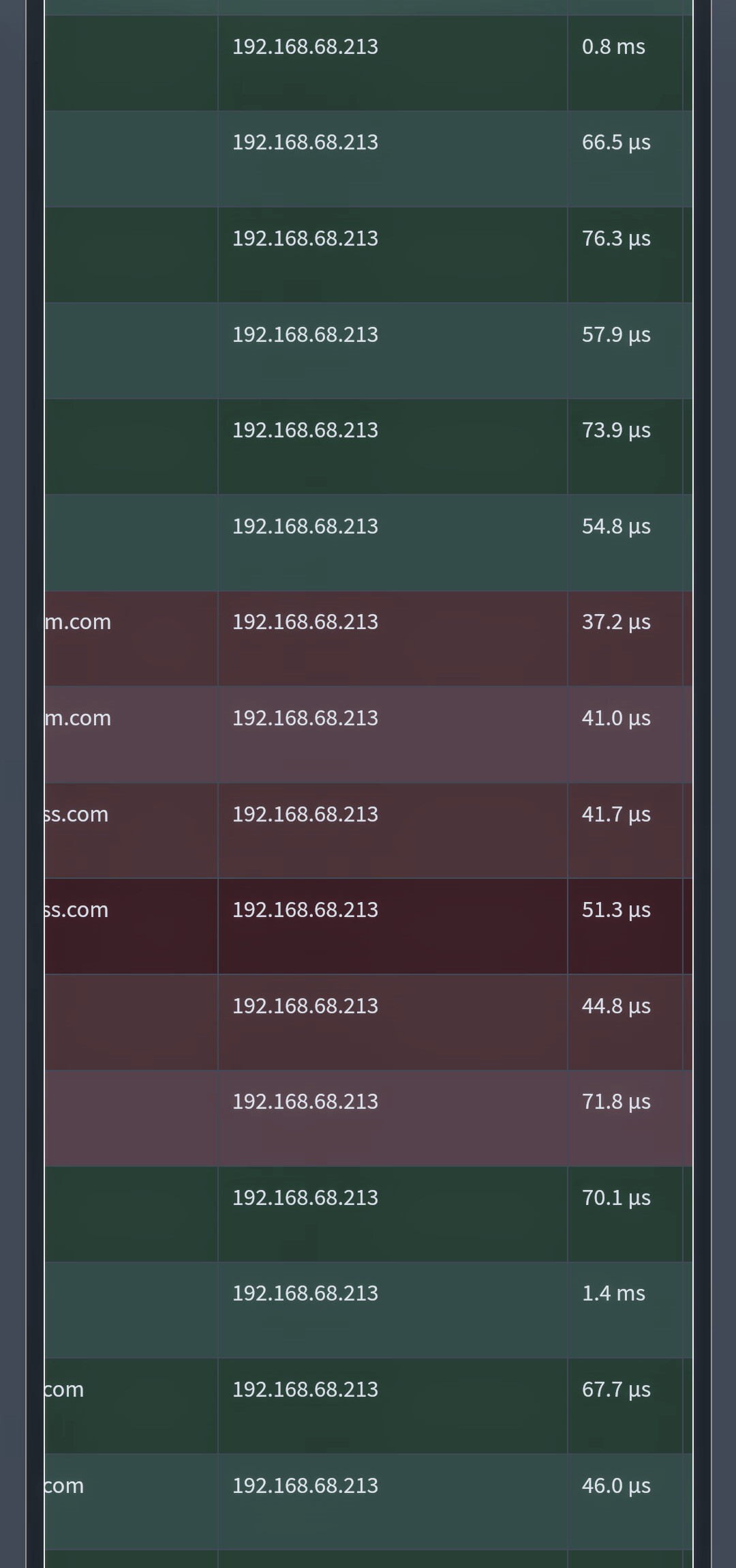

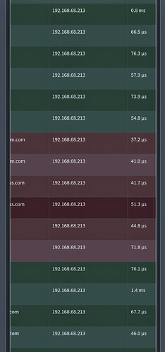

The third image is the time for Pi-hole v6 beta to resolve the same domains.
You can see that for the first domain (dpm.demdex.net) that Pi-hole v5 was quicker at 0.5ms, whereas Pi-hole v6 beta took 0.8ms.
Thereafter, Pi-hole v6 beta seems to shift to time measured in µs (ie. microseconds). Now, the last time I checked 1ms = 1000µs
So, Pi-hole v6 betas measurement of 66.5µs to resolve the second domain lookup, is orders-of-magnitude faster than v5's measurement of 0.9ms.
66.5µs = 0.0665ms, so that would mean Pi-hole v6 beta is approximately 13 times faster than Pi-hole v5's time of 0.9ms.
So, here's my question: is this right? Is Pi-hole v6 beta really 13 times faster at resolving domains than v5?

No, and this cannot be said from such single measurements. I know you have said that you didn't want to do it too scientifically but such numbers should still be sound when being discussed.
We have not done any such benchmarks as doing them thoroughly is complicated and doesn't provide much insight else than something you'd put something glossy selling magazine (and Pi-hole is not "sold" :wink: ). Please don't see this disparaging of anything you did here, just to explain why we have not put the necessary effort into it.
What makes this difficult is the very large parallelism going on in Pi-hole making measurements very difficult. DNS is an asynchronous protocol. Just let me give a rather simplified example:
  1. A client makes a query
  2. If you Pi-hole is idle at this very moment, it immediately processes the query,
  3. and sends a reply
This is the ideal case, but what may happen as well is:
  1. A client is makes a query
  2. your Pi-hole is currently busy with something else and picks up the query a tiny moment later (it is strictly FIFO). This already adds some unforseeable delay to the processing time, then while processing the reply it may happen that
  3. you are currently using the web interface and the API has to provide some numbers for which a consistent data base is necessary (e.g. while preparing the data for a page of the Query Log page). While this consistent state is active, no new queries can be processed, only thereafter
  4. the reply is generated and sent to the client.
It is very possible that the same process takes 60 µs while the second takes 6 ms although the same version of Pi-hole on the same machine - yet we see a factor of 100x difference just caused by external influences.
