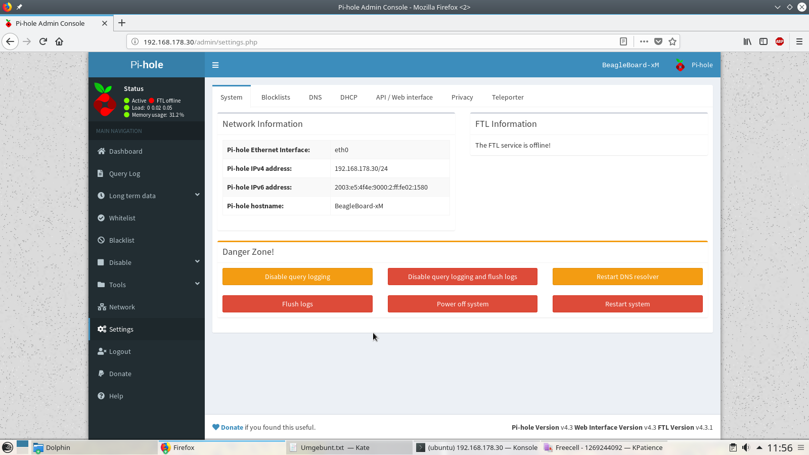

Switching off connman made FTL start. Great, thanks!

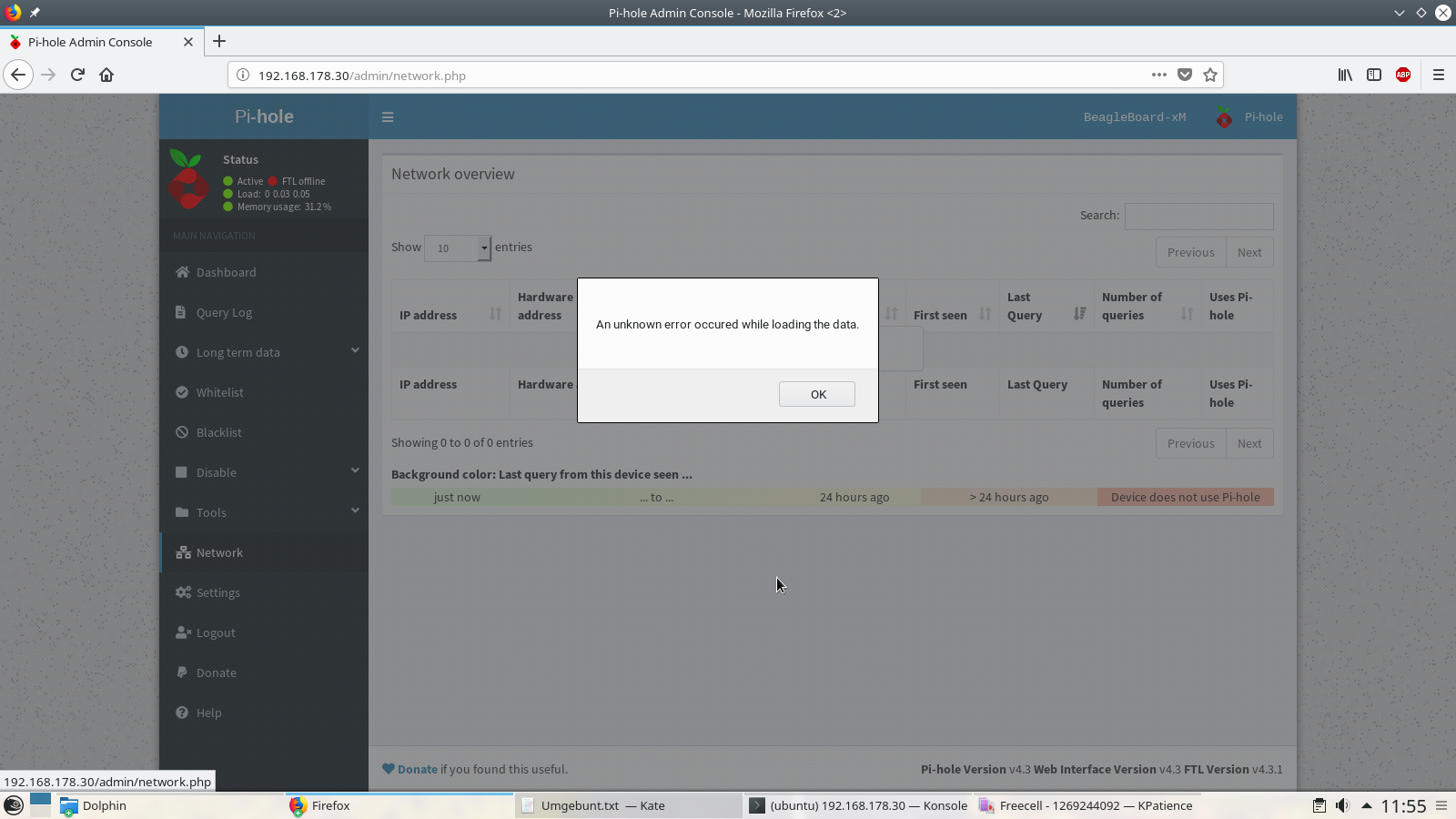

There is a small detail left: The Network-Tab
starts with an error. The Settings-Tab looks much better now:

Find out your PHP version:
pi@noads:~ $ php-cgi -v
PHP 7.0.33-0+deb9u3 (cgi-fcgi) (built: Mar  8 2019 10:01:24)
Copyright (c) 1997-2017 The PHP Group
Zend Engine v3.0.0, Copyright (c) 1998-2017 Zend Technologies
    with Zend OPcache v7.0.33-0+deb9u3, Copyright (c) 1999-2017, by Zend Technologies
Check if below two PHP mods are installed (might need to replace the 7.0 bit with your version of PHP):
pi@noads:~ $ apt policy php7.0-json php7.0-sqlite3
php7.0-json:
  Installed: 7.0.33-0+deb9u3
  Candidate: 7.0.33-0+deb9u3
  Version table:
 *** 7.0.33-0+deb9u3 500
        500 http://raspbian.raspberrypi.org/raspbian stretch/main armhf Packages
        100 /var/lib/dpkg/status
php7.0-sqlite3:
  Version table:
And check if enabled:
pi@noads:~ $ php-cgi -m
[PHP Modules]
json
sqlite3
If not installed:
sudo apt install php7.0-json php7.0-sqlite3
And check if enabled again with php-cgi -m .
If not enabled, run below one:
pi@noads:~ $ sudo phpenmod json sqlite3
pi@noads:~ $
And check again with php-cgi -m .
If all dandy, restart nginx to apply:
sudo service nginx restart

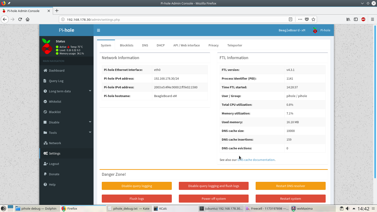

Thank you, thank you, thank you! Following your suggestions step by step the Pi-hole works for my little network. Extremely cool!
I disabeled connmand entirely. Still BeagleBoard comes up asking DHCP for an IP (not optimal) but without connmand pihole-FTL works. So I try not to reboot the board :wink:
