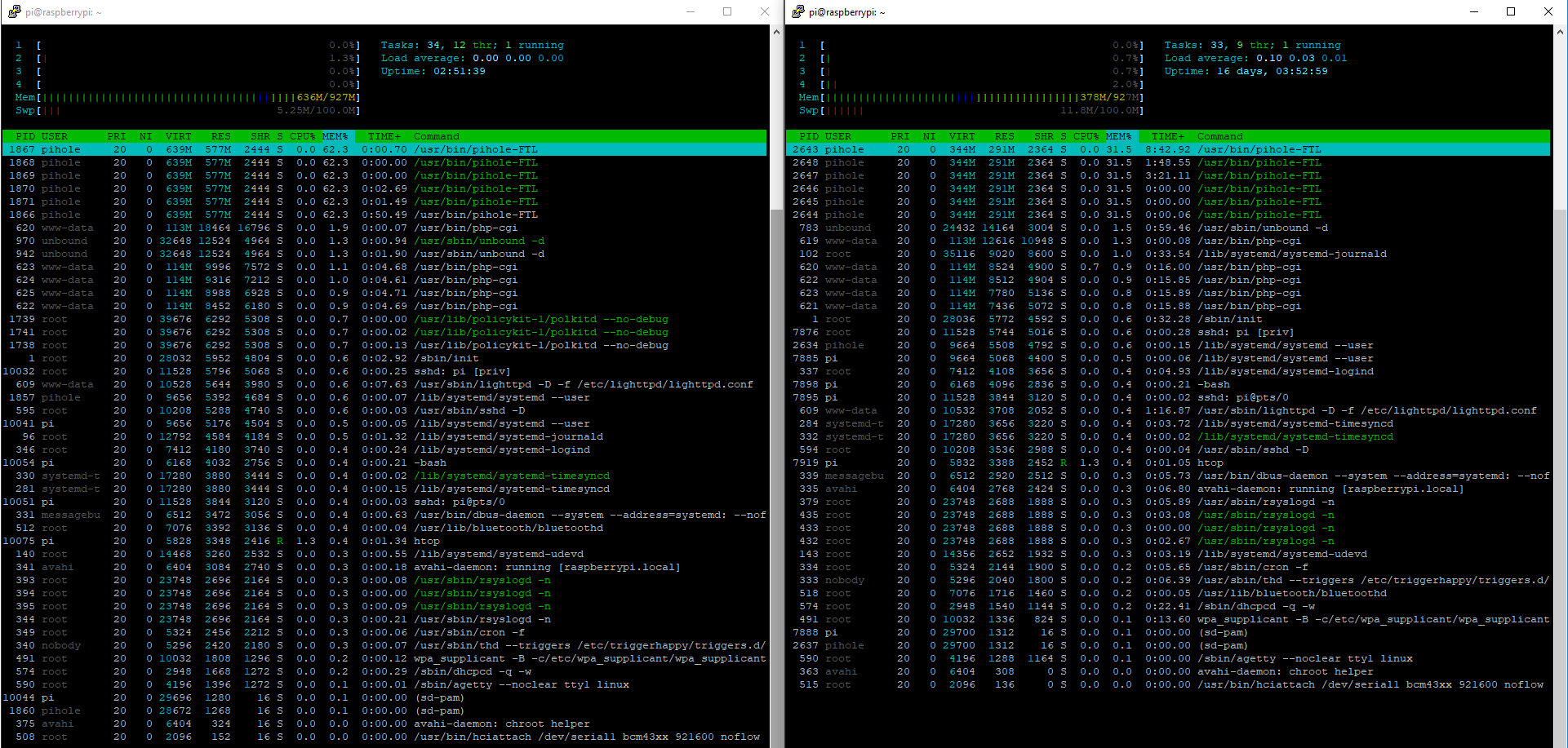

I've noticed a near 30% increase in memory usage by pihole-FTL, however I admit my block list is quite large.
That's strange since I've been testing piholeFTL since beta and didn't notice the increased memory usage until the upgrade.
I appreciate the detailed explanation. The increased memory usage had me concerned. This can be added to the release post for v4.0 as it wasn't mentioned there. Thanks.
Hi, So the problem of mrzephyrus I can only confirm. After a certain update of FTLDNS Beta, the Ram consumption has doubled and has since been the same. I have previously had ~ 31% utilization on 4 million entries and now it is ~ 70%. I can even provide a screenshot, but I can not generate a debug code anymore.
As long as you don't run out of RAM, it is not a problem.
During the beta phase, we experimented with various blocking methods. Please try using the NXDOMAIN blocking mode and see if this gives you again the ~ 31% memory usage. See Blocking mode - Pi-hole documentation
You need to restart / reload (SIGHUP) pihole-FTL to enable the change.
Hey, thank you for the reply. I have just added the blocking mode NXDOMAIN and entered the command SIGHOL pihole -ftl but also execute from pihole -g nothing has changed. I had to restart the pihole after the commands and now I'm at 38% Ram utilization. Thank you! Finally a solution :slight_smile:
