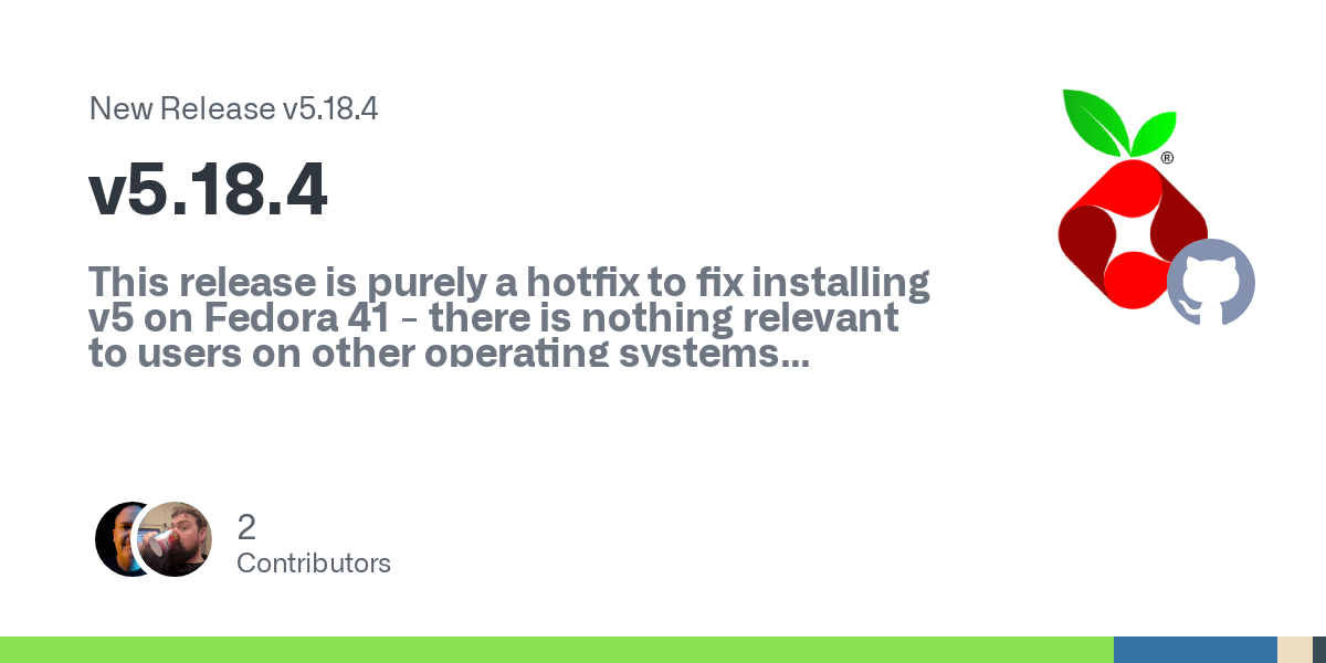

For what it's worth - there is nothing in this update of any interest to anyone other than people installing on Fedora 41
