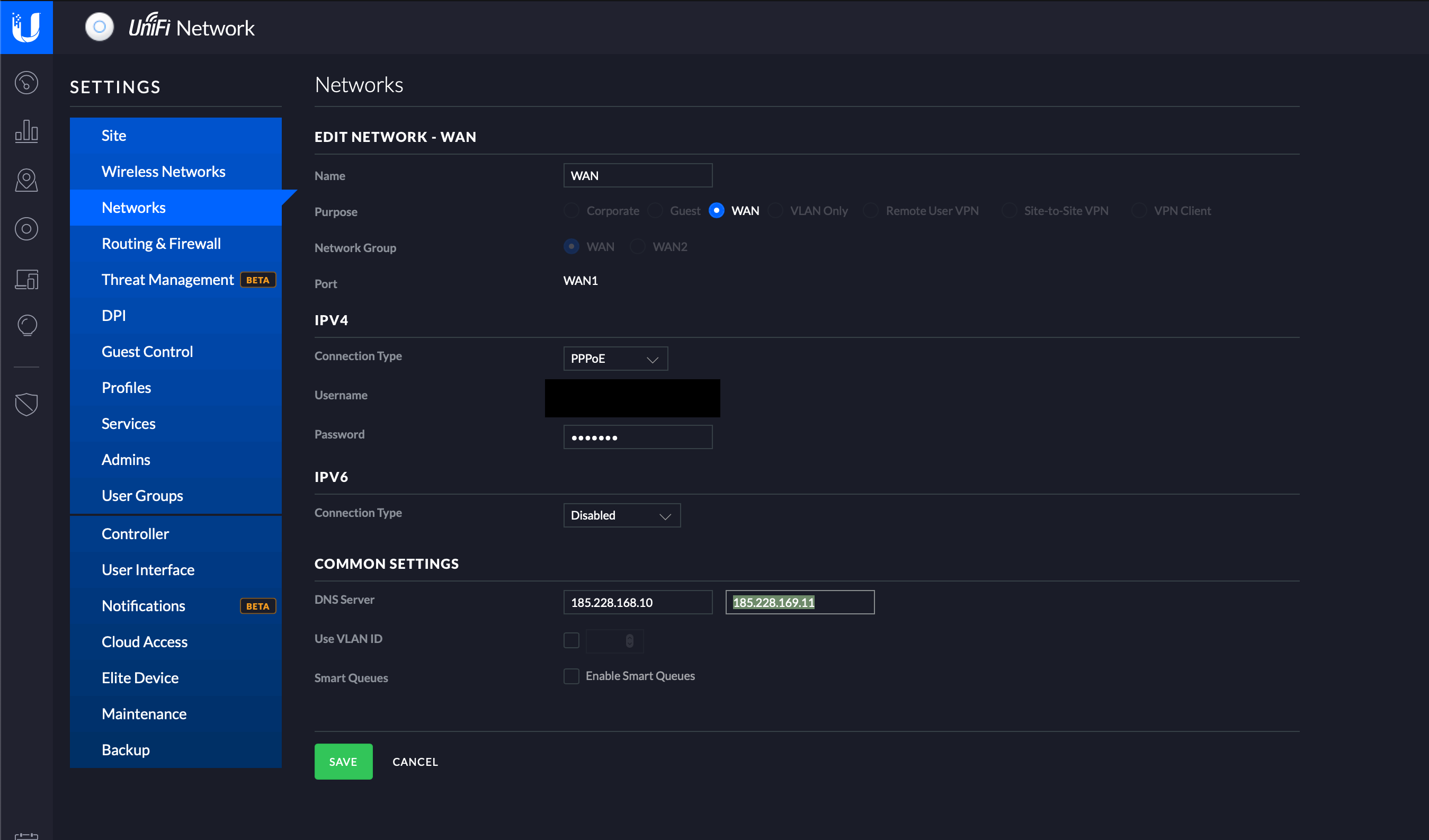

2.1.- Unifi Controller / Settings / Network / WAN --> Edit.
2.2.- In DNS Servers fill with the DNS servers that you will be using, Not the pi-holes IP, but the DNS forwarders you may need. I.E I'm using now the cleanBrowsing DNS servers: 185.228.168.10 and 185.228.169.11:

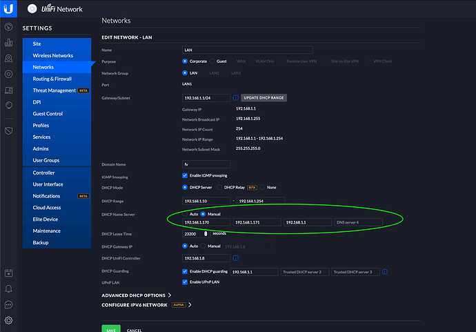

2.3.- Unifi Controller / Settings / Network / LAN --> Edit.
2.4.- Enable DHCP server and provide DHCP name server manual with the IP's of your PiHole's and your USG IP as secondary DNS or Tertiary if you are using 2 PiHole's:

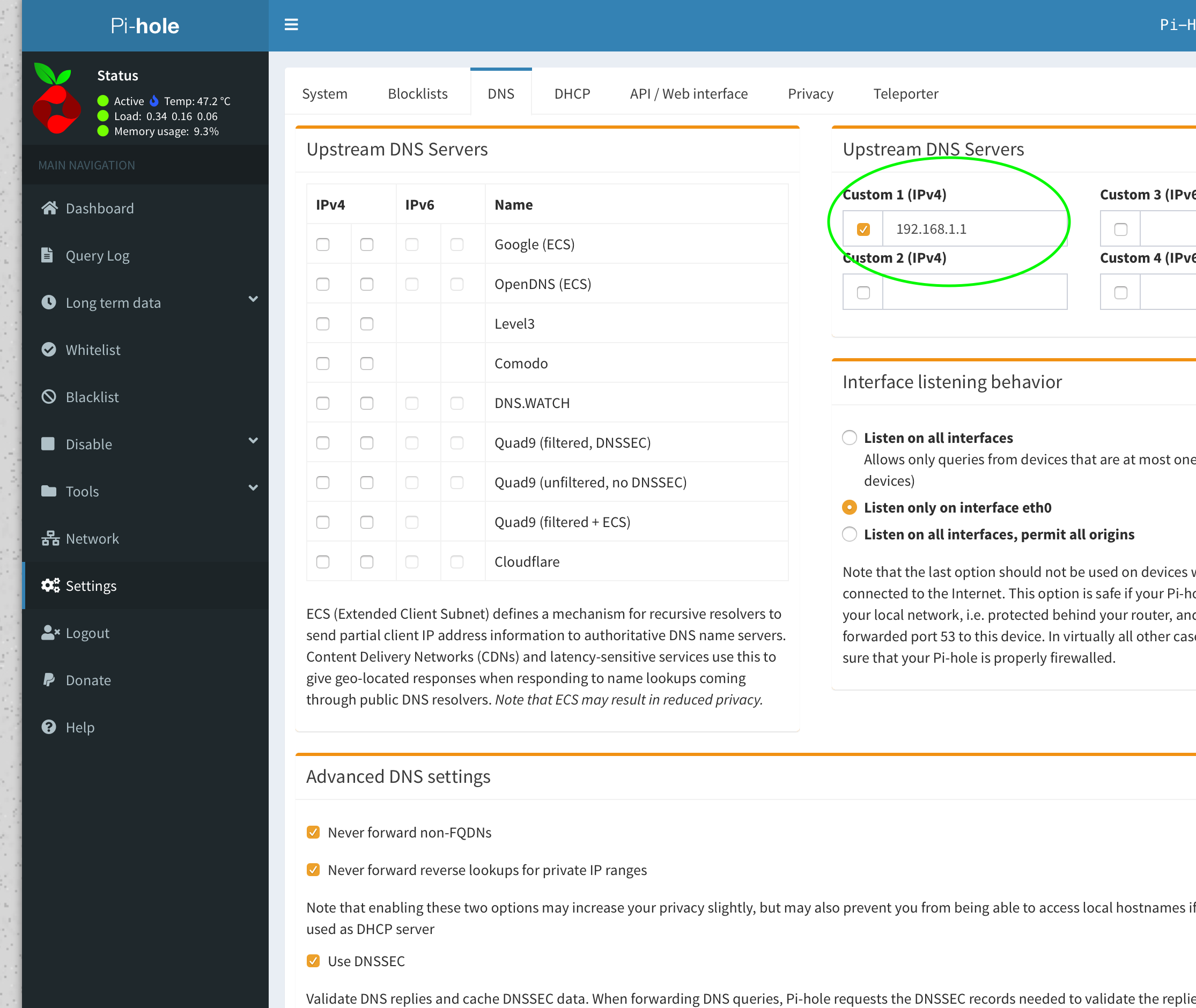

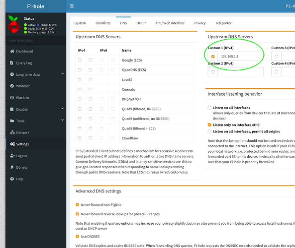

3.- Configure the PiHole via admin panel / Settings /DNS in every Pihole you own and configure as Custom IPV4 with the IP of your USG (in my case 192.168.1.1):
Now everything should work fine.
