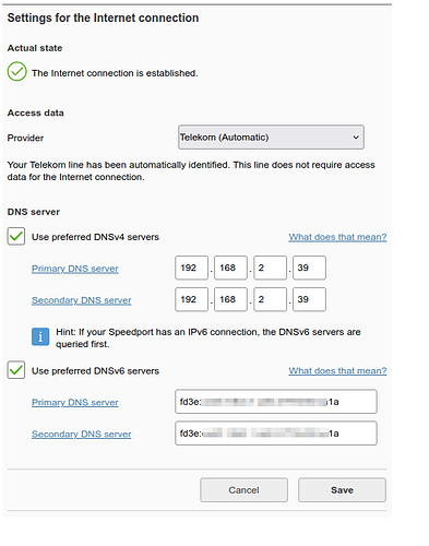

Hello everyone,
I have problems actually blocking ads with pi-hole.
I am currently running pi-hole together with unbound on a VM running Ubuntu 24.04.1 LTS (Server).
My router is a Telekom Speedport Smart 4.
I have pi-hole set up as DHCP-server and disabled the DHCP-server in the router. I set up pi-hole as preferred DNSv4 and DNSv6 servers inside my router. The option for the router to use a ULA is turned on. The upstream DNS servers inside pi-hole for IPv4 are 127.0.0.1#5335 and not set for IPv6.
For unbound I used the default config file as proposed here.
Pi-hole versions:
nslookup gives the following output:
$ nslookup flurry.com
Server:		192.168.2.1
Address:	192.168.2.1#53
Address: 0.0.0.0
Address: ::
nslookup flurry.com pi.hole
Server:		pi.hole
Address:	fd3e:ced5:18b3:1:a00:27ff:fe50:ba1a#53
Address: 0.0.0.0
Address: ::
So it seems like it should be working, but somehow I still get ads served after all.
I expect pi-hole to block ads and have them not shown.
When visiting pages with my laptop, pi-hole logs show blocked queries, but the corresponding ads are still served. When visiting the same pages with my phone, ads are shown, but pi-hole logs are not showing blocked queries either.
https://tricorder.pi-hole.net/gJSoxlQ6/
I am totally lost at this point. Any help is highly appreciated!
Edit: Some information I wanted to add, but forgot to put in the original post:
The connection to my laptop is wired. The laptop runs Ubuntu 24.04.1 LTS. One problem I just noticed is, that /etc/resolv.conf shows too many DNS servers configured.
The phone is on wifi. The private DNS setting on the phone is set to off.

Thank you for your reply!
Yes, they belong to my router. The 2 nameservers above the search line might be from the pi-hole however.
I thought I had disabled my routers IPv6 DNS, when I set my preferred DNSv4 and DNSv6 servers to the pi-hole, see screenshot below.
But apparently this is not enough. I will look through the documentation, as you proposed.
