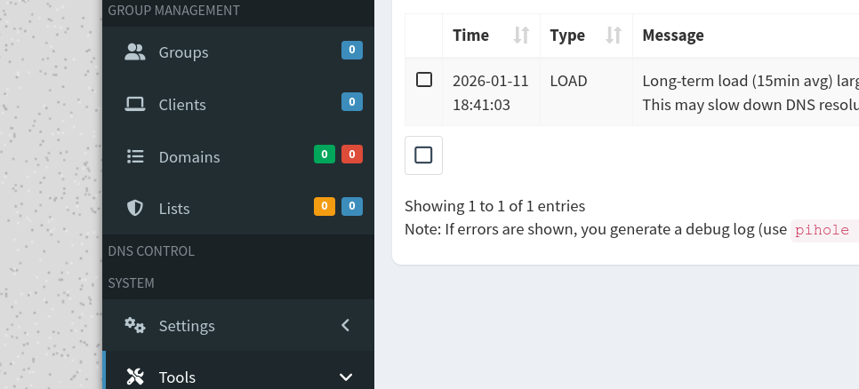

After updateing to the recend version my UI is missing “DNS CONTROL” menu.
I’m unable to edit / change my static DNS eintries for some local services (MQTT endpoints)
The UI is throwing errors like
and the clickable menu is missing

Apache can't correctly execute the web interface pages.
The Lua code uses some functions that connects directly with pihole-FTL, but Apache will never know how to call FTL functions. Pi-hole v6 needs the default web server, embedded in pihole-FTL. Other web servers won't be able to execute the pages.
