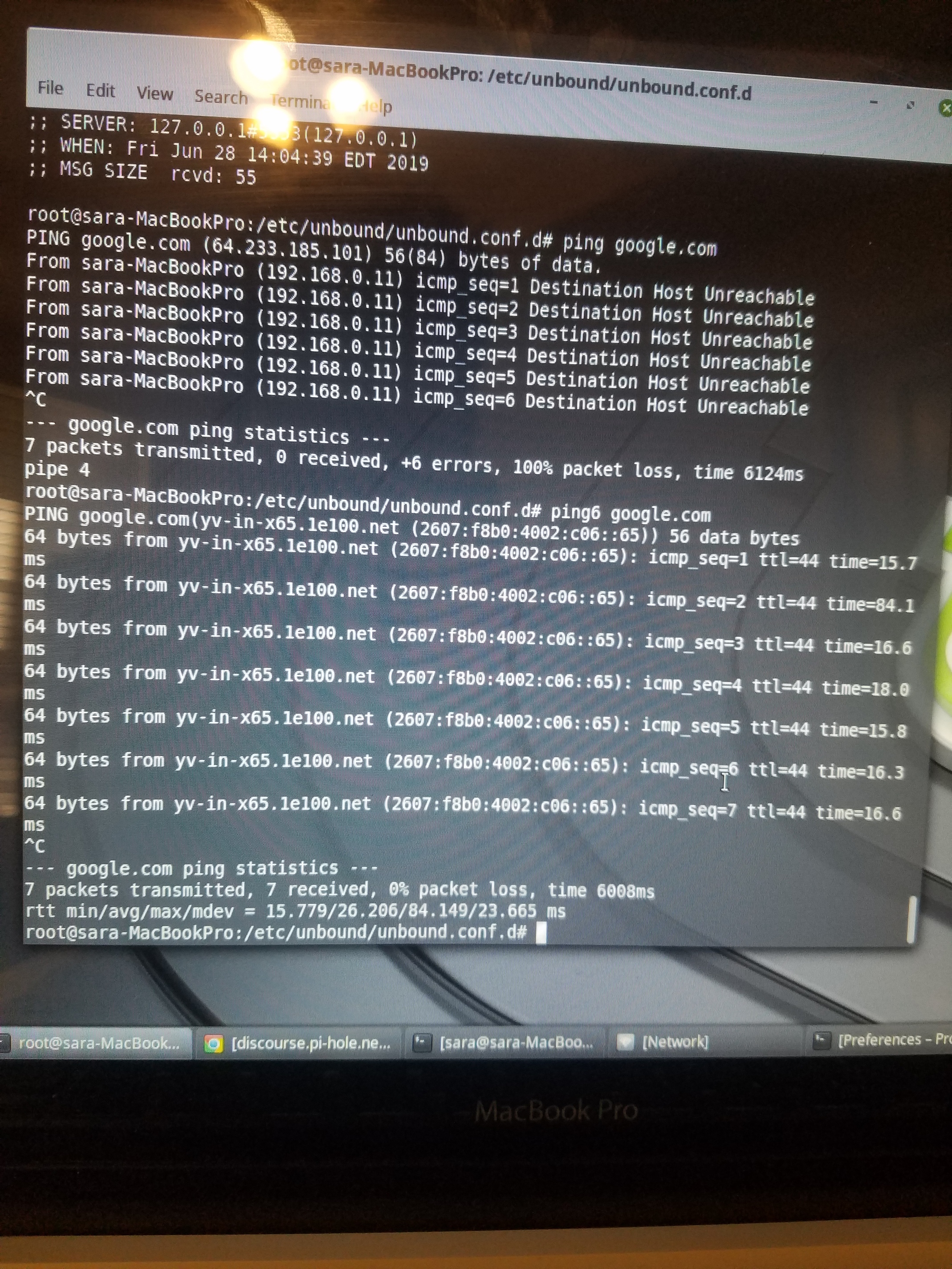

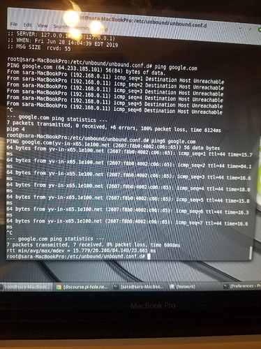

I am unable to ping domains from the pi-hole linux box but ping6 works for some reason. I can even run the dig commands and they resolve correctly. But trying to browse the web via web browser, update pihole blocklists, or update the system all fail due to dns not resolving.
I cannot ssh into the linux box to copy text bc I can't get openssh to install and didn't have it set up beforehand so I'll have to copy some pics into here:
As you can see in the last one, for some reason ping ipv4 isnt working but ping6 is. Destination host unreachable message I have seen before when I have set up other pi-hole instances.

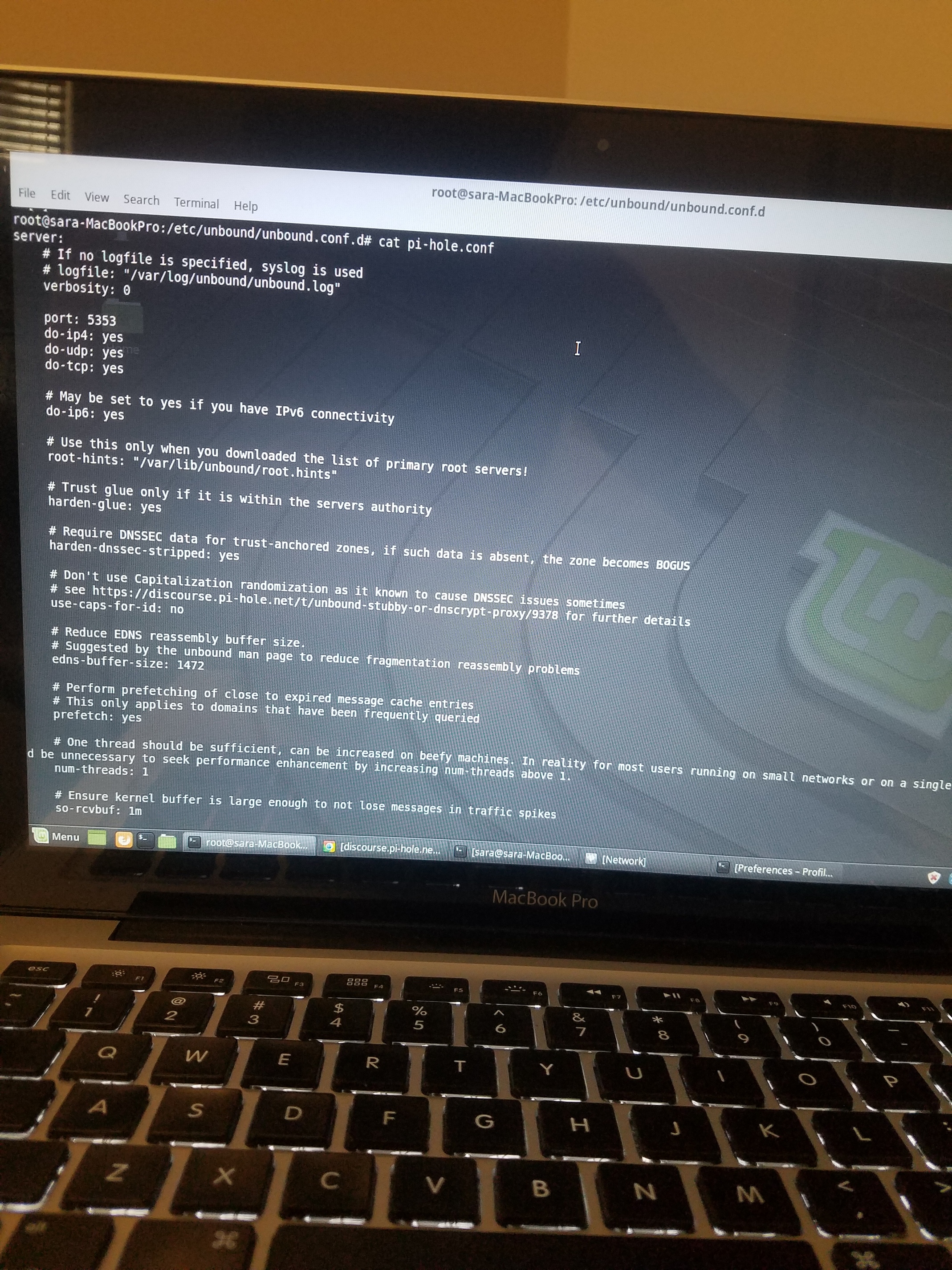

Here is the unbound/pi-hole.conf:
]_

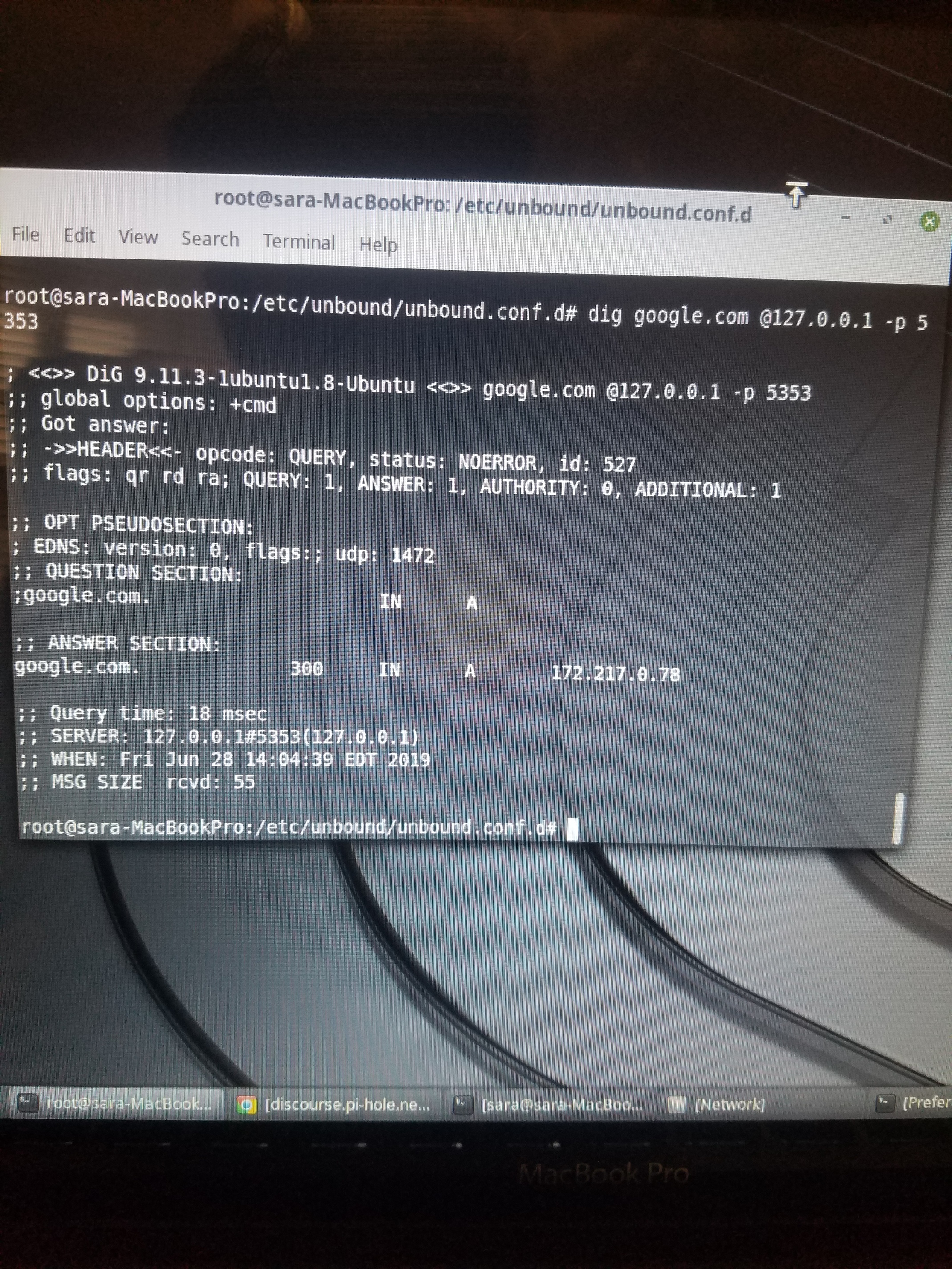

Your DNS service IS working (IPV4 included) as per one of your screenshots, the IP of google.com was resolved by the DNS query.
The problem lies with routing, gateway settings maybe ?
As for IPV6, if both IPV6 and IPV4 are present (active) within a network, IPV6 is preferred.
I believe this is not related with Pi-hole or Unbound since everything in the screenshots, is showing that they work.
DNS is only there to "translate" google.com or whatever domain name one might want to access, to an IP (since a name is easier to remember than the IP address) and again, based on your screenshots, it seems to be doing just that.
How it connects AFTER it knows the translation, depends on the local settings/parameters/routing, things that are outside the scope and functionality of Pi-hole and unbound for that matter.
What happens if you put the IP that's resolved by ping in the browser?

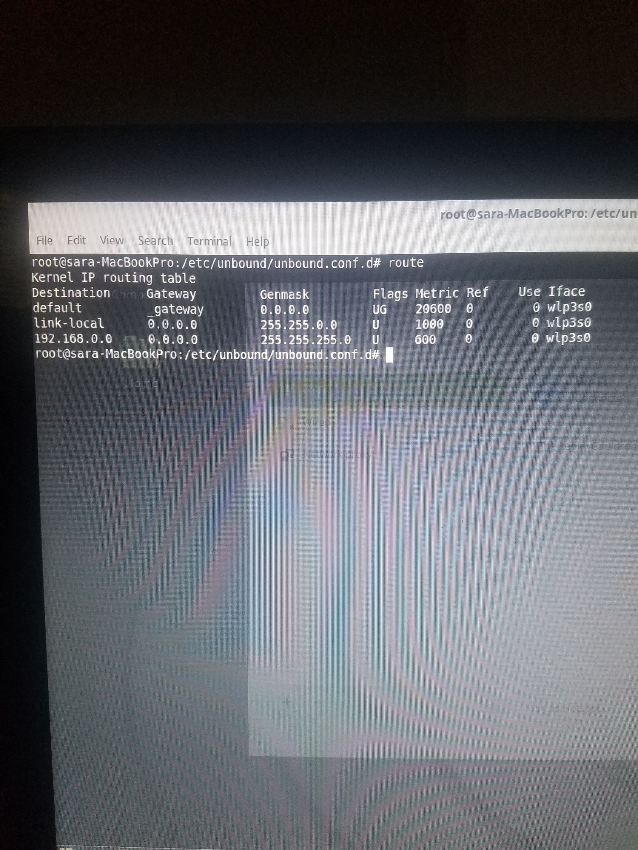

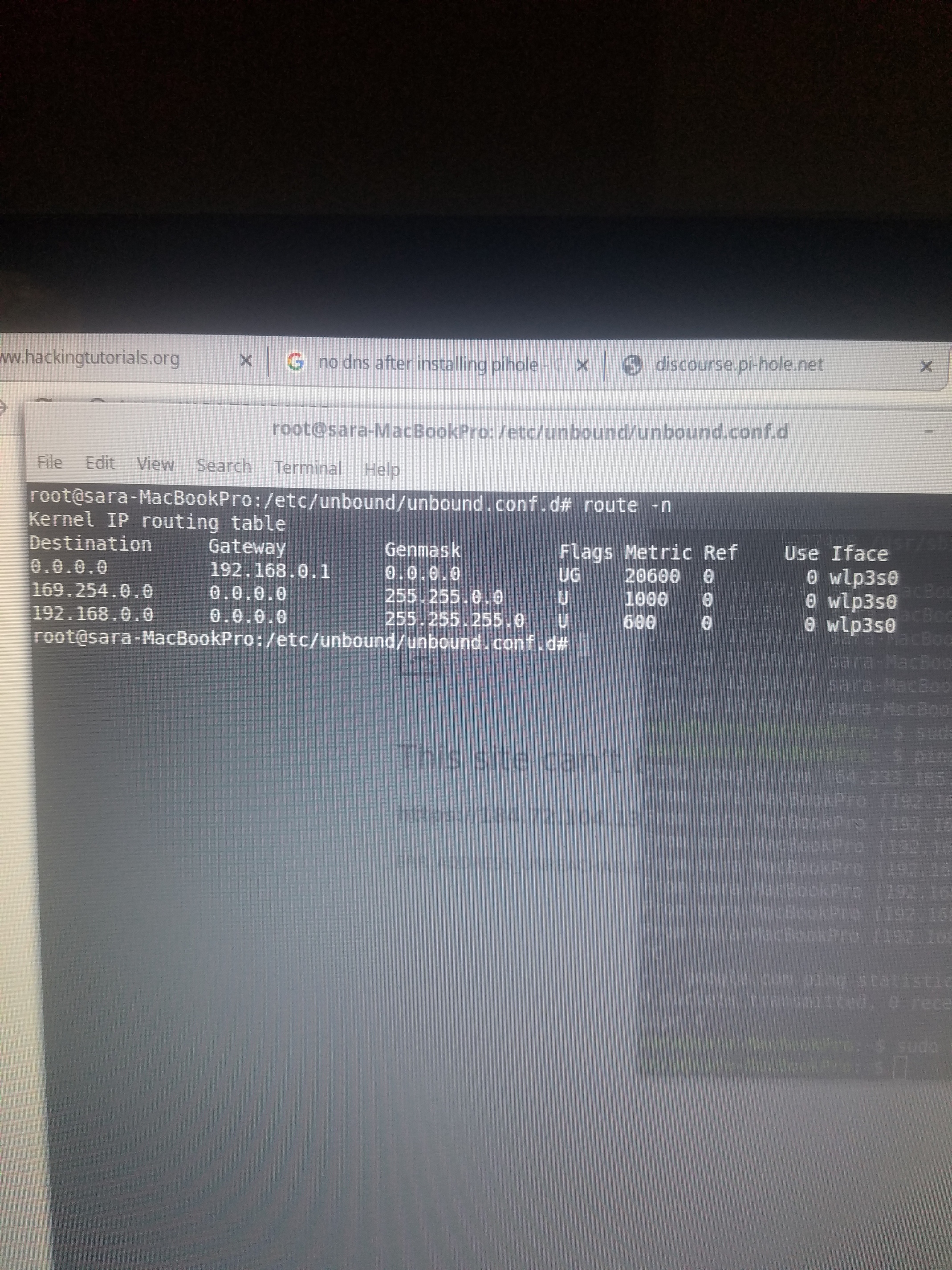

So this doesn't look right to me. I feel like the first line should read:
default 192.168.0.1 0.0.0.0
Not sure about the Flags or Metric. The Iface is correct.
Not sure if the other two lines are correct either. Also not sure how this got fiddled with in the first place.

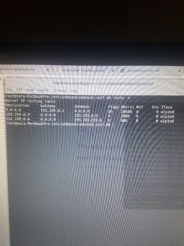

Regarding the route: I misspoke, the command was incorrect. This looks fine to me now. Thoughts?
Last screenshot routes looks ok

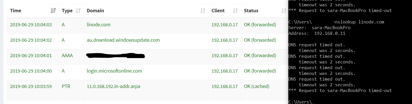

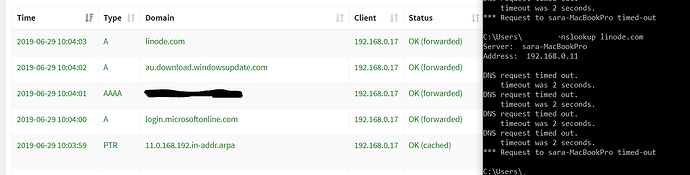

So this is on a separate machine, 192.x.x.17, and I don't understand why this would happen. The .17 is asking the pi-hole (.11) for the IP of linode.com, the pi-hole forwards the IP to the .17 machine, and the .17 machine says that the request timed out. Why would this happen?

I use nslookup on a random pc in my house via Windows command line. Looking up the ip of linode.com. The pihole web console clearly shows the query from my random computer (. 17) and says that the answer is forwarded to that machine. While the actual machine says the pihole timed out.
Pi-hole forwards the DNS query to its upstream configured DNS server.
I believe in your case thats Unbound on 127.0.0.1:5353.
Actual machine doing the DNS query times out probably because Unbound is not responding quick enough.
EDIT: try do lookup from that Windows client with a name that Pi-hole knows about and wont need to forward:
nslookup pi.hole 192.168.0.11
So when the pihole responds and says "forwarded" it's not handing the ip off to my pc, it's forwarding it to the upstream dns server?
Yes its forwarding the DNS query for name linode.com to its upstream configured DNS.
Try do lookup from that Windows client with a name that Pi-hole knows about and wont need to forward:
EDIT: typo :wink:
