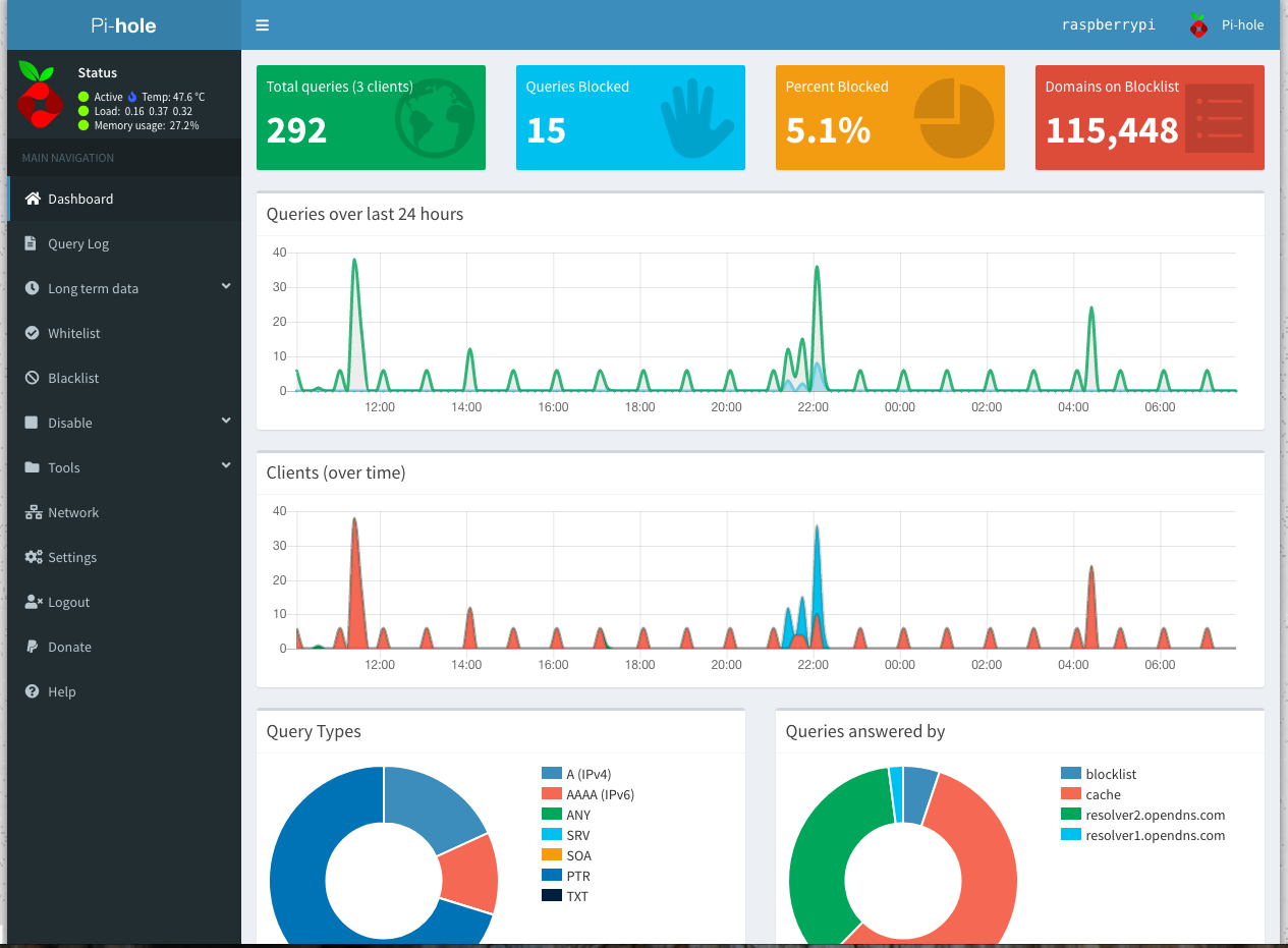

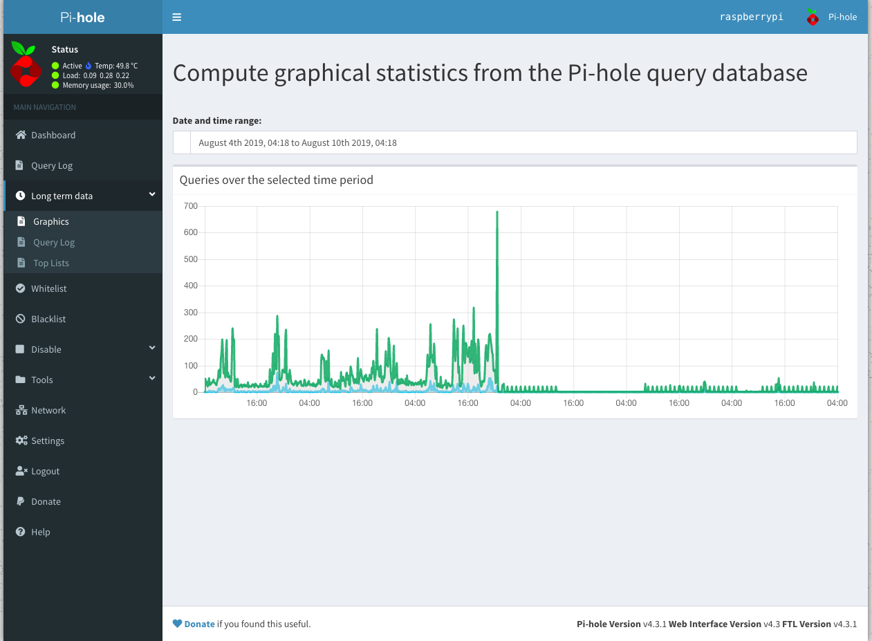

Now it seems to work again, but the graph looks different, and there is a device with activity every hour. Most hits seem to be from a tivo domain, look at the token below and at this screenshot
What is happening here? the Pi seems to block fewer domains, but I still don't see ads. You can see the gap where the Pi has crashed, and before that and after that there is that strange periodic activity every hour.

  • Is there a specific reason you're showing the long-term statistics?

  • It may be that your Pi crashed due to another reason (maybe a power issue), the one spike to 700 doesn't seem that extraordinary.
  • Have you tried to reconnect your devices to the network / restart them? Maybe they just noticed that the Pi-hole wasn't there any more.

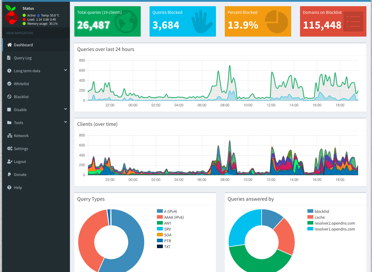

Here is what I see today. I just woke up, all of us, so this is whatever the deviced in the house did overnight.

Thanks. Interesting that it didn't do those before. I wonder what changed? You asked how the dashboard looks like. Here it is. The Pi is plougged directly into the router so all devices should use that as DNS.
Do you expect more than three clients on the network (one of them will be the Pi). That's a pretty small amount of traffic for 24 hours.

I don't think the problem lies in your Pi-Hole. Your debug log shows that Pi-Hole is properly processing received DNS entries. What appears to have happened is that some of the clients are no longer using Pi-Hole (as evidenced from your screen shot from the long term database showing a step traffic change a few days ago). Did you update your router or anything else about that time?
