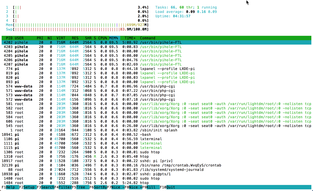

At random time (within 24 hrs of running) pi-hole it stops working with FTL error and when I run htop, it shows CPU usage 100% or even more with memory usage of about 80% or higher. Currently I restarted rasberry pi and everything seems to be fine but i see memory usage almost 70% which I believe at some point will cause pi-hole to stop working again.

Htop screenshot here..
With your large number of blocked domains in gravity (a few million), you may be pushing your memory limits, depending on what hardware you are running. With this many domains in gravity and using the NULL blocking mode, there have been reports of high CPU and RAM usage. Here is one related thread:

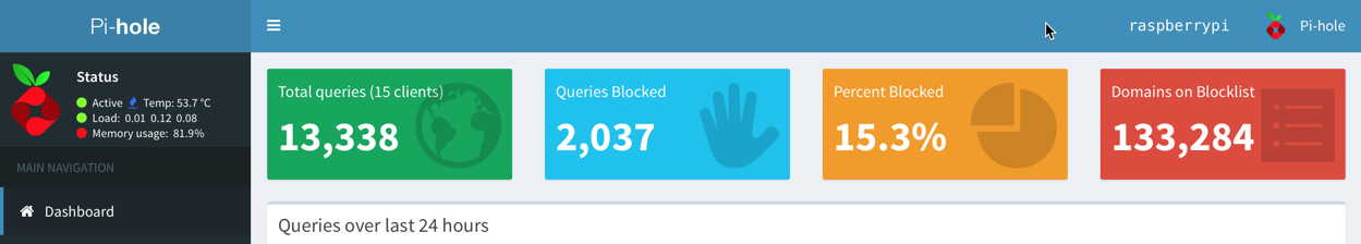

This seems to have resolved the issue. Here is before and after screenshot. The impact was significant. Now memory usage is 14% vs 83%.
lo jiu8nhy78

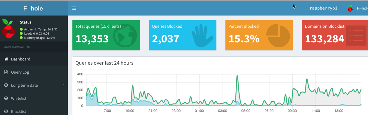

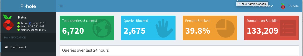

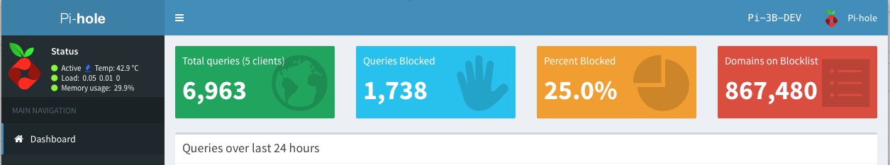

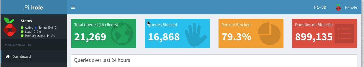

Good that this improved things. I'm still curious why your RAM usage was so high before - that's not usual for that many domains and queries. Just for comparison, I have several Pi-Holes that serve subsets of clients, with different options for testing, etc. Here are the same screen shots for these. The closest to your setup is the last and it sits about about 20% RAM usage.
Pi 3B+ with V4.0 master, wired, BLOCKINGMODE=IP-NODATA-AAAA
Pi 3B+ with development latest version, wireless, BLOCKINGMODE=NULL
Pi ZeroW with V4.0 master, wireless, BLOCKINGMODE=IP-NODATA-AAAA
