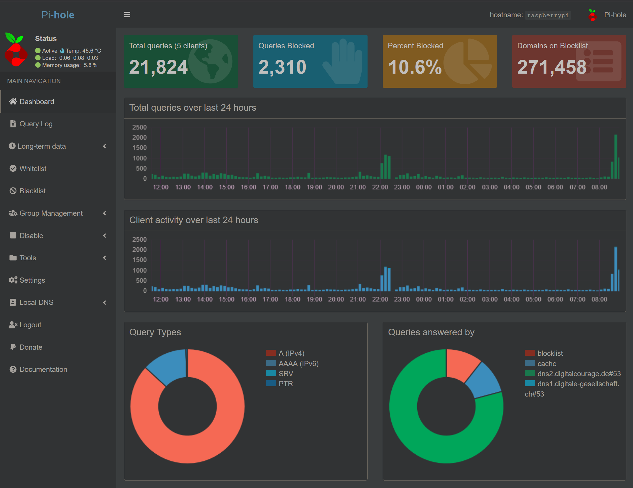

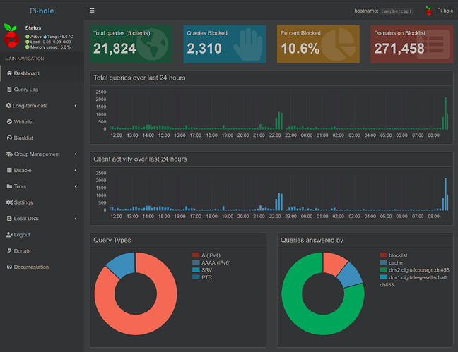

Weirdly enough the pi-hole started sending DNS replies again by itself, a few minutes after it had stopped, without me restarting the DNS resolver this time (I was still waiting for the debug log to be generated, to no avail).
And I've noticed that the number of queries rises significantly with the outage (both during yesterday evenings outage and just now), which I can't explain:

   [2020-12-30 11:48:17.586 4724M]    MAXDBDAYS: max age for stored queries is 365 days
   [2020-12-30 11:48:17.586 4724M]    RESOLVE_IPV6: Resolve IPv6 addresses
   [2020-12-30 11:48:17.586 4724M]    RESOLVE_IPV4: Resolve IPv4 addresses
   [2020-12-30 11:48:17.586 4724M]    DBINTERVAL: saving to DB file every minute
   [2020-12-30 11:48:17.586 4724M]    DBFILE: Using /etc/pihole/pihole-FTL.db
   [2020-12-30 11:48:17.586 4724M]    MAXLOGAGE: Importing up to 24.0 hours of log data
   [2020-12-30 11:48:17.587 4724M]    PRIVACYLEVEL: Set to 0
   [2020-12-30 11:48:17.587 4724M]    IGNORE_LOCALHOST: Show queries from localhost
   [2020-12-30 11:48:17.587 4724M]    BLOCKINGMODE: Null IPs for blocked domains
   [2020-12-30 11:48:17.587 4724M]    ANALYZE_ONLY_A_AND_AAAA: Disabled. Analyzing all queries
   [2020-12-30 11:48:17.587 4724M]    DBIMPORT: Importing history from database
   [2020-12-30 11:48:17.587 4724M]    PIDFILE: Using /run/pihole-FTL.pid
   [2020-12-30 11:48:17.587 4724M]    PORTFILE: Using /run/pihole-FTL.port
   [2020-12-30 11:48:17.587 4724M]    SOCKETFILE: Using /run/pihole/FTL.sock
   [2020-12-30 11:48:17.587 4724M]    SETUPVARSFILE: Using /etc/pihole/setupVars.conf
   [2020-12-30 11:48:17.587 4724M]    MACVENDORDB: Using /etc/pihole/macvendor.db
   [2020-12-30 11:48:17.587 4724M]    GRAVITYDB: Using /etc/pihole/gravity.db
   [2020-12-30 11:48:17.587 4724M]    PARSE_ARP_CACHE: Active
   [2020-12-30 11:48:17.587 4724M]    CNAME_DEEP_INSPECT: Active
   [2020-12-30 11:48:17.587 4724M]    DELAY_STARTUP: No delay requested.
   [2020-12-30 11:48:17.587 4724M]    BLOCK_ESNI: Enabled, blocking _esni.{blocked domain}
   -----tail of pihole-FTL.log------
   [2020-12-30 11:48:23.568 4798M]    GRAVITYDB: Using /etc/pihole/gravity.db
   [2020-12-30 11:48:23.568 4798M]    PARSE_ARP_CACHE: Active
   [2020-12-30 11:48:23.568 4798M]    CNAME_DEEP_INSPECT: Active
   [2020-12-30 11:48:23.568 4798M]    DELAY_STARTUP: No delay requested.
   [2020-12-30 11:48:23.568 4798M]    BLOCK_ESNI: Enabled, blocking _esni.{blocked domain}
   [2020-12-30 11:48:23.568 4798M]    NICE: Set process niceness to -10 (default)
   [2020-12-30 11:48:23.568 4798M]    MAXNETAGE: Removing IP addresses and host names from network table after 365 days
   [2020-12-30 11:48:23.568 4798M]    NAMES_FROM_NETDB: Enabled, trying to get names from network database
   [2020-12-30 11:48:23.568 4798M]    EDNS0_ECS: Overwrite client from ECS information
   [2020-12-30 11:48:23.568 4798M]    REFRESH_HOSTNAMES: Periodically refreshing IPv4 names
   [2020-12-30 11:48:23.568 4798M] Finished config file parsing
   [2020-12-30 11:48:23.568 4798M] Creating mutex
   [2020-12-30 11:48:23.570 4798M] Database version is 9
   [2020-12-30 11:48:23.570 4798M] Imported 0 alias-clients
   [2020-12-30 11:48:23.571 4798M] Database successfully initialized
   [2020-12-30 11:48:23.571 4798M] New upstream server: 46.182.19.48:53 (0/1024)
   [2020-12-30 11:48:23.572 4798M] Imported 34 queries from the long-term database
   [2020-12-30 11:48:23.572 4798M]  -> Total DNS queries: 34
   [2020-12-30 11:48:23.572 4798M]  -> Cached DNS queries: 2
   [2020-12-30 11:48:23.572 4798M]  -> Forwarded DNS queries: 29
   [2020-12-30 11:48:23.572 4798M]  -> Blocked DNS queries: 3
   [2020-12-30 11:48:23.572 4798M]  -> Unknown DNS queries: 0
   [2020-12-30 11:48:23.572 4798M]  -> Unique domains: 12
   [2020-12-30 11:48:23.572 4798M]  -> Unique clients: 3
   [2020-12-30 11:48:23.572 4798M]  -> Known forward destinations: 1
   [2020-12-30 11:48:23.572 4798M] Successfully accessed setupVars.conf
   [2020-12-30 11:48:23.577 4800M] PID of FTL process: 4800
   [2020-12-30 11:48:23.577 4800/T4801] Listening on port 4711 for incoming IPv4 telnet connections
   [2020-12-30 11:48:23.578 4800/T4802] Listening on port 4711 for incoming IPv6 telnet connections
   [2020-12-30 11:48:23.578 4800/T4803] Listening on Unix socket
   [2020-12-30 11:48:23.578 4800M] INFO: FTL is running as user pihole (UID 999)
   [2020-12-30 11:48:23.579 4800M] Reloading DNS cache
   [2020-12-30 11:48:23.579 4800M] Blocking status is enabled
   [2020-12-30 11:48:23.706 4800/T4804] Compiled 7 whitelist and 0 blacklist regex filters for 3 clients in 4.0 msec
   [2020-12-30 11:49:35.664 4800M] New upstream server: 185.95.218.42:53 (1/1024)
*** [ DIAGNOSING ]: contents of /dev/shm
-rw------- 1 pihole pihole 339968 Dec 30 11:48 /dev/shm/FTL-clients
-rw------- 1 pihole pihole 144 Dec 30 11:48 /dev/shm/FTL-counters
-rw------- 1 pihole pihole 4096 Dec 30 11:48 /dev/shm/FTL-dns-cache
-rw------- 1 pihole pihole 65536 Dec 30 11:48 /dev/shm/FTL-domains
-rw------- 1 pihole pihole 28 Dec 30 11:48 /dev/shm/FTL-lock
-rw------- 1 pihole pihole 20480 Dec 30 11:48 /dev/shm/FTL-overTime
-rw------- 1 pihole pihole 4096 Dec 30 11:48 /dev/shm/FTL-per-client-regex
-rw------- 1 pihole pihole 229376 Dec 30 11:49 /dev/shm/FTL-queries
-rw------- 1 pihole pihole 12 Dec 30 11:48 /dev/shm/FTL-settings
-rw------- 1 pihole pihole 4096 Dec 30 11:48 /dev/shm/FTL-strings
-rw------- 1 pihole pihole 28672 Dec 30 11:48 /dev/shm/FTL-upstreams
*** [ DIAGNOSING ]: Pi-hole diagnosis messages
*** [ DIAGNOSING ]: Locale
    LANG=en_GB.UTF-8
-rw-r--r-- 1 pihole pihole 33252 Dec 30 11:49 /var/log/pihole.log
   -----head of pihole.log------
   Dec 30 11:48:13 dnsmasq[4605]: query[A] r5---sn-h0jeenek.googlevideo.com from 192.168.178.2
   Dec 30 11:48:13 dnsmasq[4605]: forwarded r5---sn-h0jeenek.googlevideo.com to 46.182.19.48
   Dec 30 11:48:13 dnsmasq[4605]: forwarded r5---sn-h0jeenek.googlevideo.com to 185.95.218.42
   Dec 30 11:48:14 dnsmasq[4605]: query[A] www.google.com from 192.168.178.2
   Dec 30 11:48:14 dnsmasq[4605]: forwarded www.google.com to 46.182.19.48
   Dec 30 11:48:14 dnsmasq[4605]: forwarded www.google.com to 185.95.218.42
   Dec 30 11:48:15 dnsmasq[4605]: query[A] nexusrules.officeapps.live.com from 192.168.178.2
   Dec 30 11:48:15 dnsmasq[4605]: gravity blocked nexusrules.officeapps.live.com is 0.0.0.0
   Dec 30 11:48:16 dnsmasq[4605]: exiting on receipt of SIGTERM
   Dec 30 11:48:17 dnsmasq[4726]: started, version pi-hole-2.82 cachesize 10000
   Dec 30 11:48:17 dnsmasq[4726]: compile time options: IPv6 GNU-getopt no-DBus no-UBus no-i18n IDN DHCP DHCPv6 Lua TFTP no-conntrack ipset auth DNSSEC loop-detect inotify dumpfile
   Dec 30 11:48:17 dnsmasq[4726]: using only locally-known addresses for domain use-application-dns.net
   Dec 30 11:48:17 dnsmasq[4726]: using nameserver 46.182.19.48#53
   Dec 30 11:48:17 dnsmasq[4726]: using nameserver 185.95.218.42#53
   Dec 30 11:48:17 dnsmasq[4726]: read /etc/hosts - 5 addresses
   Dec 30 11:48:17 dnsmasq[4726]: read /etc/pihole/custom.list - 0 addresses
   Dec 30 11:48:17 dnsmasq[4726]: read /etc/pihole/local.list - 2 addresses
   Dec 30 11:48:18 dnsmasq[4726]: query[A] epdg.epc.mnc002.mcc262.pub.3gppnetwork.org from 192.168.178.14
   Dec 30 11:48:18 dnsmasq[4726]: forwarded epdg.epc.mnc002.mcc262.pub.3gppnetwork.org to 46.182.19.48
   Dec 30 11:48:18 dnsmasq[4726]: forwarded epdg.epc.mnc002.mcc262.pub.3gppnetwork.org to 185.95.218.42
[✓] ** FINISHED DEBUGGING! **
    * For more information, see: https://pi-hole.net/2016/11/07/crack-our-medical-tricorder-win-a-raspberry-pi-3/
    * If available, we'll use openssl to upload the log, otherwise it will fall back to netcat.
    * curl failed, falling back to netcat for transmission.
nc: getaddrinfo for host "tricorder.pi-hole.net" port 9999: Temporary failure in name resolution
[✗]  There was an error uploading your debug log.
   * A local copy of the debug log can be found at: /var/log/pihole_debug.log
Here is also a longer log of the issue:
Dec 30 11:56:07 dnsmasq[4800]: query[A] diagnostics.meethue.com from 192.168.178.2
Dec 30 11:56:07 dnsmasq[4800]: exactly blacklisted diagnostics.meethue.com is 0.0.0.0
Dec 30 11:56:08 dnsmasq[4800]: query[A] go.microsoft.com from 192.168.178.2
Dec 30 11:56:08 dnsmasq[4800]: forwarded go.microsoft.com to 46.182.19.48
Dec 30 11:56:08 dnsmasq[4800]: forwarded go.microsoft.com to 185.95.218.42
Dec 30 11:56:08 dnsmasq[4800]: query[A] r5---sn-h0jeln7r.googlevideo.com from 192.168.178.2
Dec 30 11:56:08 dnsmasq[4800]: forwarded r5---sn-h0jeln7r.googlevideo.com to 46.182.19.48
Dec 30 11:56:08 dnsmasq[4800]: forwarded r5---sn-h0jeln7r.googlevideo.com to 185.95.218.42
Dec 30 11:56:09 dnsmasq[4800]: query[A] r5---sn-h0jeln7r.googlevideo.com from 192.168.178.2
Dec 30 11:56:09 dnsmasq[4800]: forwarded r5---sn-h0jeln7r.googlevideo.com to 46.182.19.48
Dec 30 11:56:09 dnsmasq[4800]: forwarded r5---sn-h0jeln7r.googlevideo.com to 185.95.218.42
Dec 30 11:56:10 dnsmasq[4800]: query[A] r5---sn-h0jeln7r.googlevideo.com from 192.168.178.2
Dec 30 11:56:10 dnsmasq[4800]: forwarded r5---sn-h0jeln7r.googlevideo.com to 46.182.19.48
Dec 30 11:56:10 dnsmasq[4800]: forwarded r5---sn-h0jeln7r.googlevideo.com to 185.95.218.42
Dec 30 11:56:11 dnsmasq[4800]: query[A] client.wns.windows.com from 192.168.178.2
Dec 30 11:56:11 dnsmasq[4800]: forwarded client.wns.windows.com to 46.182.19.48
Dec 30 11:56:11 dnsmasq[4800]: forwarded client.wns.windows.com to 185.95.218.42
Dec 30 11:56:12 dnsmasq[4800]: query[A] go.microsoft.com from 192.168.178.2
Dec 30 11:56:12 dnsmasq[4800]: forwarded go.microsoft.com to 46.182.19.48
Dec 30 11:56:12 dnsmasq[4800]: forwarded go.microsoft.com to 185.95.218.42
Dec 30 11:56:12 dnsmasq[4800]: query[A] r5---sn-h0jeln7r.googlevideo.com from 192.168.178.2
Dec 30 11:56:12 dnsmasq[4800]: forwarded r5---sn-h0jeln7r.googlevideo.com to 46.182.19.48
Dec 30 11:56:12 dnsmasq[4800]: forwarded r5---sn-h0jeln7r.googlevideo.com to 185.95.218.42
Dec 30 11:56:12 dnsmasq[4800]: query[A] client.wns.windows.com from 192.168.178.2
Dec 30 11:56:12 dnsmasq[4800]: forwarded client.wns.windows.com to 46.182.19.48
Dec 30 11:56:12 dnsmasq[4800]: forwarded client.wns.windows.com to 185.95.218.42
Dec 30 11:56:13 dnsmasq[4800]: query[A] go.microsoft.com from 192.168.178.2
Dec 30 11:56:13 dnsmasq[4800]: forwarded go.microsoft.com to 46.182.19.48
Dec 30 11:56:13 dnsmasq[4800]: forwarded go.microsoft.com to 185.95.218.42
Dec 30 11:56:13 dnsmasq[4800]: query[A] client.wns.windows.com from 192.168.178.2
Dec 30 11:56:13 dnsmasq[4800]: forwarded client.wns.windows.com to 46.182.19.48
Dec 30 11:56:13 dnsmasq[4800]: forwarded client.wns.windows.com to 185.95.218.42
Dec 30 11:56:14 dnsmasq[4800]: query[A] go.microsoft.com from 192.168.178.2
Dec 30 11:56:14 dnsmasq[4800]: forwarded go.microsoft.com to 46.182.19.48
Dec 30 11:56:14 dnsmasq[4800]: forwarded go.microsoft.com to 185.95.218.42
Dec 30 11:56:15 dnsmasq[4800]: query[A] client.wns.windows.com from 192.168.178.2
Dec 30 11:56:15 dnsmasq[4800]: forwarded client.wns.windows.com to 46.182.19.48
Dec 30 11:56:15 dnsmasq[4800]: forwarded client.wns.windows.com to 185.95.218.42
Dec 30 11:56:16 dnsmasq[4800]: query[A] go.microsoft.com from 192.168.178.2
Dec 30 11:56:16 dnsmasq[4800]: forwarded go.microsoft.com to 46.182.19.48
Dec 30 11:56:16 dnsmasq[4800]: forwarded go.microsoft.com to 185.95.218.42
Dec 30 11:56:16 dnsmasq[4800]: query[A] r5---sn-h0jeln7r.googlevideo.com from 192.168.178.2
Dec 30 11:56:16 dnsmasq[4800]: forwarded r5---sn-h0jeln7r.googlevideo.com to 46.182.19.48
Dec 30 11:56:16 dnsmasq[4800]: forwarded r5---sn-h0jeln7r.googlevideo.com to 185.95.218.42
Dec 30 11:56:17 dnsmasq[4800]: query[A] ws.pusherapp.com from 192.168.178.2
Dec 30 11:56:17 dnsmasq[4800]: forwarded ws.pusherapp.com to 46.182.19.48
Dec 30 11:56:17 dnsmasq[4800]: forwarded ws.pusherapp.com to 185.95.218.42
Dec 30 11:56:18 dnsmasq[4800]: query[A] ws.pusherapp.com from 192.168.178.2
Dec 30 11:56:18 dnsmasq[4800]: forwarded ws.pusherapp.com to 46.182.19.48
Dec 30 11:56:18 dnsmasq[4800]: forwarded ws.pusherapp.com to 185.95.218.42
Dec 30 11:56:19 dnsmasq[4800]: query[A] client.wns.windows.com from 192.168.178.2
Dec 30 11:56:19 dnsmasq[4800]: forwarded client.wns.windows.com to 46.182.19.48
Dec 30 11:56:19 dnsmasq[4800]: forwarded client.wns.windows.com to 185.95.218.42
Dec 30 11:56:19 dnsmasq[4800]: query[A] ws.pusherapp.com from 192.168.178.2
Dec 30 11:56:19 dnsmasq[4800]: forwarded ws.pusherapp.com to 46.182.19.48
Dec 30 11:56:19 dnsmasq[4800]: forwarded ws.pusherapp.com to 185.95.218.42
Dec 30 11:56:20 dnsmasq[4800]: query[AAAA] www.ecdinterface.philips.com from 192.168.178.2
Dec 30 11:56:20 dnsmasq[4800]: exactly blacklisted www.ecdinterface.philips.com is ::
Dec 30 11:56:20 dnsmasq[4800]: query[A] go.microsoft.com from 192.168.178.2
Dec 30 11:56:20 dnsmasq[4800]: forwarded go.microsoft.com to 46.182.19.48
Dec 30 11:56:20 dnsmasq[4800]: forwarded go.microsoft.com to 185.95.218.42
Dec 30 11:56:20 dnsmasq[4800]: query[A] r5---sn-h0jeenek.googlevideo.com from 192.168.178.2
Dec 30 11:56:20 dnsmasq[4800]: forwarded r5---sn-h0jeenek.googlevideo.com to 46.182.19.48
Dec 30 11:56:20 dnsmasq[4800]: forwarded r5---sn-h0jeenek.googlevideo.com to 185.95.218.42
Dec 30 11:56:20 dnsmasq[4800]: query[A] sockjs.pusher.com from 192.168.178.2
Dec 30 11:56:20 dnsmasq[4800]: forwarded sockjs.pusher.com to 46.182.19.48
Dec 30 11:56:20 dnsmasq[4800]: forwarded sockjs.pusher.com to 185.95.218.42
Dec 30 11:56:21 dnsmasq[4800]: query[A] r5---sn-h0jeenek.googlevideo.com from 192.168.178.2
Dec 30 11:56:21 dnsmasq[4800]: forwarded r5---sn-h0jeenek.googlevideo.com to 46.182.19.48
Dec 30 11:56:21 dnsmasq[4800]: forwarded r5---sn-h0jeenek.googlevideo.com to 185.95.218.42
Dec 30 11:56:21 dnsmasq[4800]: query[A] sockjs.pusher.com from 192.168.178.2
Dec 30 11:56:21 dnsmasq[4800]: forwarded sockjs.pusher.com to 46.182.19.48
Dec 30 11:56:21 dnsmasq[4800]: forwarded sockjs.pusher.com to 185.95.218.42
Dec 30 11:56:21 dnsmasq[4800]: query[A] ws.pusherapp.com from 192.168.178.2
Dec 30 11:56:21 dnsmasq[4800]: forwarded ws.pusherapp.com to 46.182.19.48
Dec 30 11:56:21 dnsmasq[4800]: forwarded ws.pusherapp.com to 185.95.218.42

Dec 30 11:56:52 dnsmasq[4800]: forwarded timeline55-clientstats1.pusher.com to 46.182.19.48
Dec 30 11:56:52 dnsmasq[4800]: forwarded timeline55-clientstats1.pusher.com to 185.95.218.42
Dec 30 11:56:52 dnsmasq[4800]: query[A] n7j5t1wt46pg.statuspage.io from 192.168.178.2
Dec 30 11:56:52 dnsmasq[4800]: forwarded n7j5t1wt46pg.statuspage.io to 46.182.19.48
Dec 30 11:56:52 dnsmasq[4800]: forwarded n7j5t1wt46pg.statuspage.io to 185.95.218.42
Dec 30 11:56:52 dnsmasq[4800]: query[A] r5---sn-h0jeenek.googlevideo.com from 192.168.178.2
Dec 30 11:56:52 dnsmasq[4800]: forwarded r5---sn-h0jeenek.googlevideo.com to 46.182.19.48
Dec 30 11:56:52 dnsmasq[4800]: forwarded r5---sn-h0jeenek.googlevideo.com to 185.95.218.42
Dec 30 11:56:53 dnsmasq[4800]: query[A] n7j5t1wt46pg.statuspage.io from 192.168.178.2
Dec 30 11:56:53 dnsmasq[4800]: forwarded n7j5t1wt46pg.statuspage.io to 46.182.19.48
Dec 30 11:56:53 dnsmasq[4800]: forwarded n7j5t1wt46pg.statuspage.io to 185.95.218.42
Dec 30 11:56:55 dnsmasq[4800]: query[A] n7j5t1wt46pg.statuspage.io from 192.168.178.2
Dec 30 11:56:55 dnsmasq[4800]: forwarded n7j5t1wt46pg.statuspage.io to 46.182.19.48
Dec 30 11:56:55 dnsmasq[4800]: forwarded n7j5t1wt46pg.statuspage.io to 185.95.218.42
Dec 30 11:56:56 dnsmasq[4800]: query[A] go.microsoft.com from 192.168.178.2
Dec 30 11:56:56 dnsmasq[4800]: forwarded go.microsoft.com to 46.182.19.48
Dec 30 11:56:56 dnsmasq[4800]: forwarded go.microsoft.com to 185.95.218.42
Dec 30 11:56:56 dnsmasq[4800]: query[A] r5---sn-h0jeln7r.googlevideo.com from 192.168.178.2
Dec 30 11:56:56 dnsmasq[4800]: forwarded r5---sn-h0jeln7r.googlevideo.com to 46.182.19.48
Dec 30 11:56:56 dnsmasq[4800]: forwarded r5---sn-h0jeln7r.googlevideo.com to 185.95.218.42
Dec 30 11:56:57 dnsmasq[4800]: query[A] epdg.epc.mnc001.mcc262.pub.3gppnetwork.org from 192.168.178.14
Dec 30 11:56:57 dnsmasq[4800]: forwarded epdg.epc.mnc001.mcc262.pub.3gppnetwork.org to 46.182.19.48
Dec 30 11:56:57 dnsmasq[4800]: forwarded epdg.epc.mnc001.mcc262.pub.3gppnetwork.org to 185.95.218.42
Dec 30 11:56:57 dnsmasq[4800]: query[A] r5---sn-h0jeln7r.googlevideo.com from 192.168.178.2
Dec 30 11:56:57 dnsmasq[4800]: forwarded r5---sn-h0jeln7r.googlevideo.com to 46.182.19.48
Dec 30 11:56:57 dnsmasq[4800]: forwarded r5---sn-h0jeln7r.googlevideo.com to 185.95.218.42
Dec 30 11:56:58 dnsmasq[4800]: query[A] client.wns.windows.com from 192.168.178.2
Dec 30 11:56:58 dnsmasq[4800]: forwarded client.wns.windows.com to 46.182.19.48
Dec 30 11:56:58 dnsmasq[4800]: forwarded client.wns.windows.com to 185.95.218.42
As you can see, queries are being received and forwarded, but no DNS replies are being sent. I don't understand why.

Any ideas?
What I don't understand either, is why the upstream DNS-server should be the issue. I've used the previous DNS-servers since I've gotten the Fritzbox about a year ago and the pi-hole was only added between client and Fritzbox initially and now again.
Update
Youtube came back by itsself after an hour, the rest after i changed the setup back to client - fritzbox - pi-hole - DNS server (cloudflare). Having the pihole after the fritzbox seems to be more stable, though in theory it shouldn't make a difference. This is weird!!!
One thing is obvious/common, its always the upstream configured DNS server(s) thats not replying or failing (from below):
