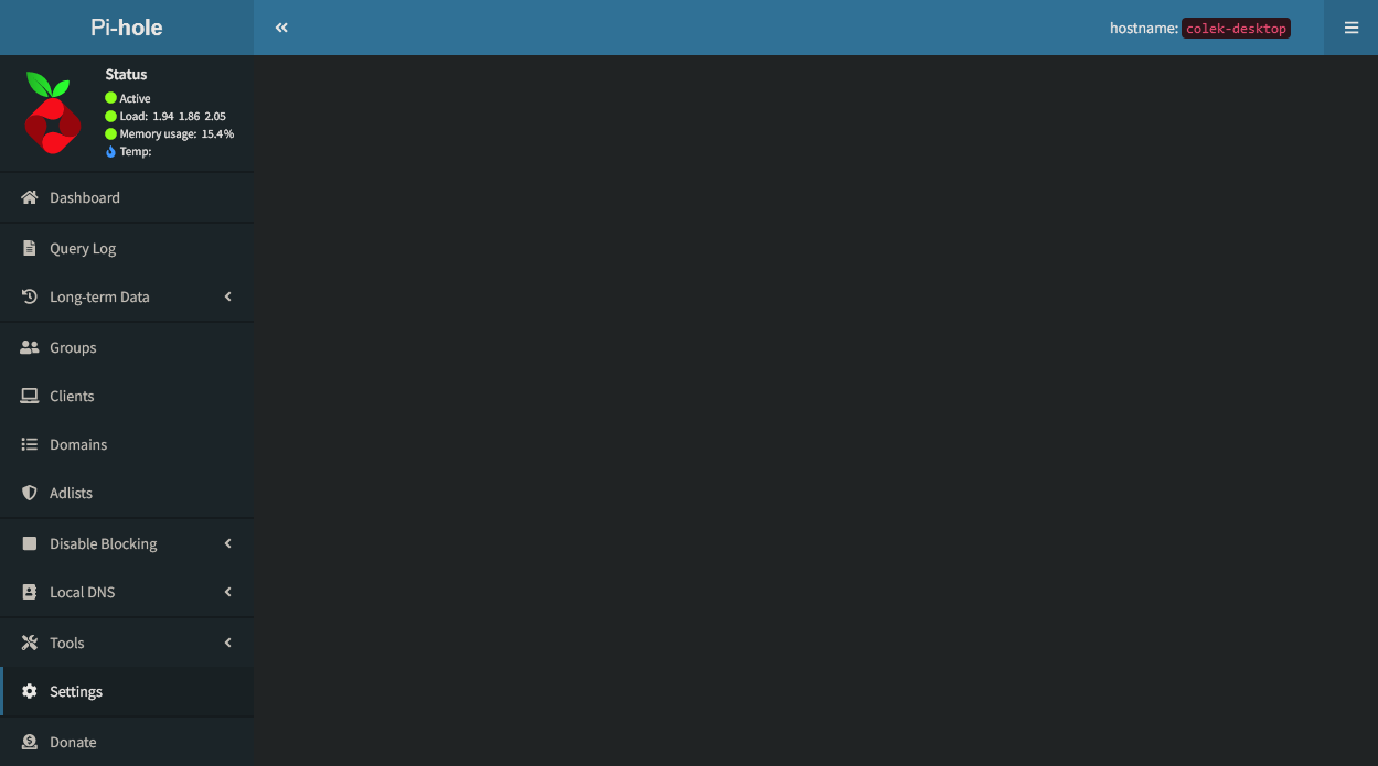

When this happends, going to Web UI's Settings results in blank page as well until I do pihole restartdns.
