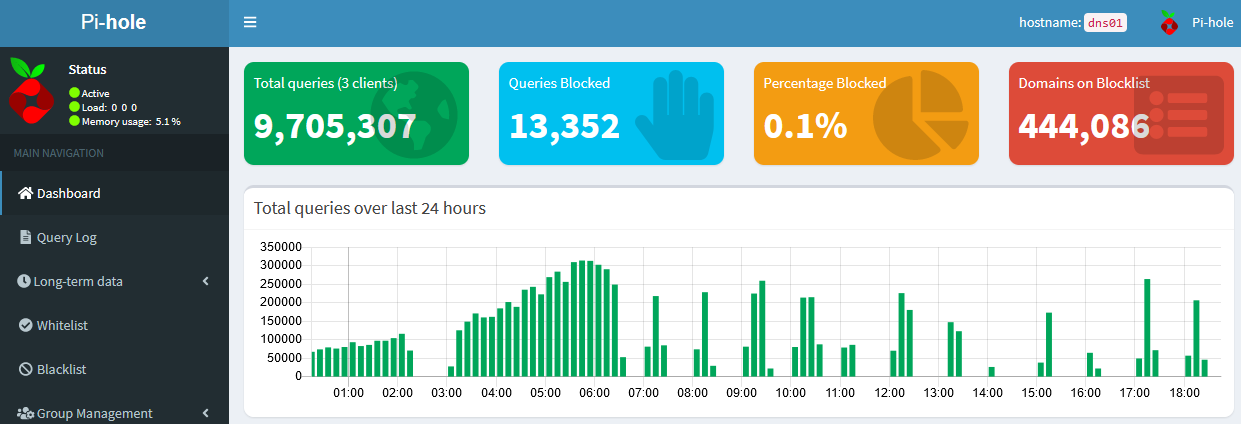

Pi-hole stops resolving after some time and only a reboot of the system / manual pihole -g brings it back online. During this aberrant behaviour, the FTL service looks fully operational and does not generate any errors.. just the resolution keeps failing. This is very similar to Pihole intermittently stops resolving until hardware reboot.
A look at the FTL logs, before and just after the time when queries stop working does not show any errors. Similarly, the dnsmasq log (pihole.log) shows that DNS query forwarding and resolution as working at this stage (all the way till 08:53 ish when no further log updates are seen in the FTL log or the pihole log.)

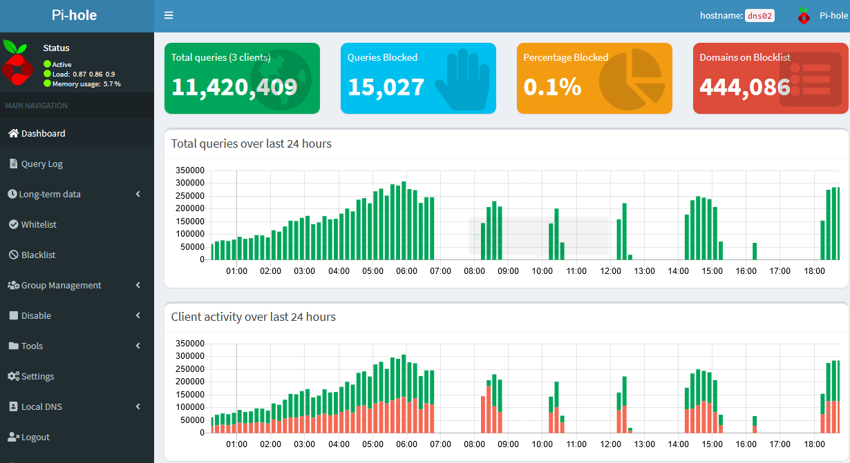

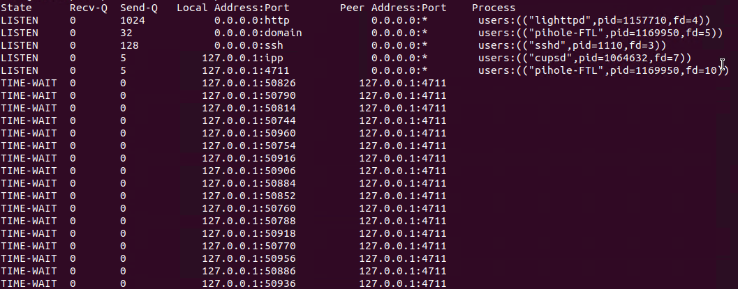

Looks like there is something making a lot of connections to the API and then getting denied:
Client denied (at max capacity of 255): 340
IPv4 telnet error: Success (0)
A quick look at ss -t -a -p confirms that all the connections to port 4711 are genuine / local and not external processes or any other scripts:
Just wondering if the developers would recommend that I compile FTL from source after editing FTL/src/FTL.h at 198e7c61362e07b22baa8bdb2bb57dd1c53be0fc · pi-hole/FTL · GitHub MAXCONNS value or is that not recommended?

Your query count looks way too high for just 5 clients.
Did you check for DNS loops?
The chart from your screenshot would suggest that Pi-hole stopped receiving any queries after a certain time. At that time, your clients just may have started using another DNS server.
It seems your router/DHCP server is not distributing your Pi-hole as DNS, allowing DHCP clients to by-pass Pi-hole. (In addition, it is providing an awful lot of time servers?)

You cannot know for the TIME-WAITs. That looks like some process connected to the API at some time in the past, but never closed the connection.
Are you perhaps using any third-party scripts that would issue Telnet API calls?
Thank you, yes, I did check for DNS loops. No issues on that front - the query count is correct for the network and as expected.
  1. Pi-hole is currently one of the "resolvers" my primary and secondary DNS forwarders are pointing towards. That is why the client number is low, but number of queries are high. Typically, I can see 20M+ queries in a day on those forwarders.
.. and another beautiful graph here:
When I have previously tested pi-hole (all clients addressing it directly), pi-hole failure would cause interruption in the network so for the moment, p-hole is one of the servers to allow some test capability without disrupting things too much.
Spot-on and totally possible, however, I have spent a few hours waiting for that gap to appear and then ran a rate-limited dig (50 parallel queries at a time, shuffled subset of 200-1000 within the TOP1M domains) and basically, all the server returns at that stage is SERVFAIL or no response. An occasional pihole -g makes it happy again..

I subsequently hit the FTL port 4711 telnet limit of port 4711. We don't have anything on these vanilla installs that would be querying or trying to connect to the API (other than the pi-hole internals). So, I have now tried to edit the FTL.h file within the source:
vi FTL/src/FTL.h
// How many client connection do we accept at once?
#define MAXCONNS 510
Changed MAXCONNS parameter to > 255 and then compiled a fresh build (hash differs from the pre-compiled binary and the system detects it as a dirty build).

  2. Absolutely no third party scripts whatsoever. I am assuming that the web GUI updates (under a huge volume of query) are causing the FTL telnet warning.. maybe reducing how often the GUI picks up / triggers the update may help?
