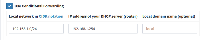

Do you have Pi-hole's Conditional Forwarding enabled?
EDIT: I see from your debug log that you actually do.
That may close a partial DNS loop if your router would use Pi-hole as an upstream DNS server.
Yes I have Conditional Forwarding enabled:

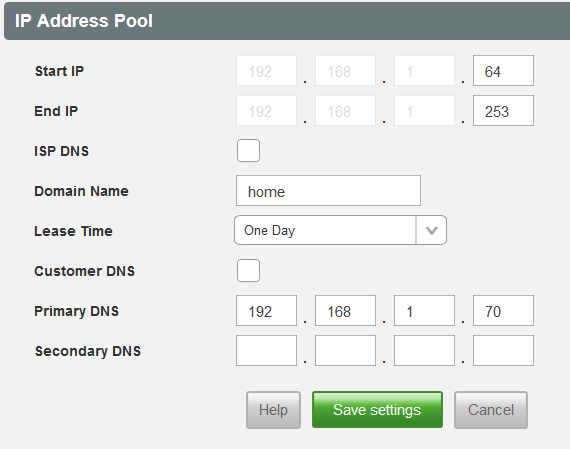

This is the DNS config settings I changed in the router under "Network > LAN"

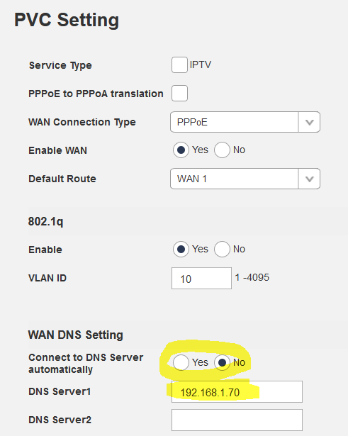

And under "Network > WAN"
I'm sorry but I don't know what you mean specifically by "upstream DNS"
Your router's LAN settings would commonly configure your router to tell its clients to talk to Pi-hole for DNS, instead of talking to your router.
Provided your router's LAN settings do that, your router doesn't receive any DNS requests from your clients anymore - except those sent by Pi-hole's CF.
Your router's WAN settting would configure the DNS service your router itself would forward its DNS queries to (hence upstream).
Your router may now pass those CF DNS requests received by Pi-hole back to Pi-hole, and Pi-hole will send them to your router, and so on and so forth, forever or until time-out.
You could try and set your router's upstream DNS to its default or a public DNS of your choice to avoid that DNS loop.

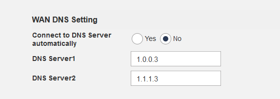

Okay, I did try disabling rate limiting and saw hundreds of thousands of requests in the pihole logs. I've turned that off again. I've set the WAN DNS settings to:
But If I remember correctly, I set it to the pihole ip because I wasn't seeing any requests being sent to the pihole when I just set the LAN DNS to the pihole.
EDIT: This is the reddit post I found which suggested setting the WAN DNS settings. I followed the steps in the images posted.
(I've likely edited my post for that additional advice while you were already trying to adjust your configuration).
