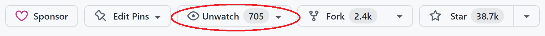

Have to admit I have removed these entries from cron, just watching the respective pihole repositories, getting a mail (3) as soon as there is a new version released.
