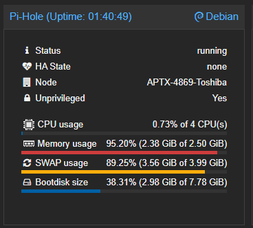

Pi-Hole is running however it's consuming 2G of RAM and 1.5G of SWAP

Fixed the issue with Pi-hole consuming all the memory of the host.
The server's time wasnt set correctly due to an error with the host. Fixing the time fixes the issue.
