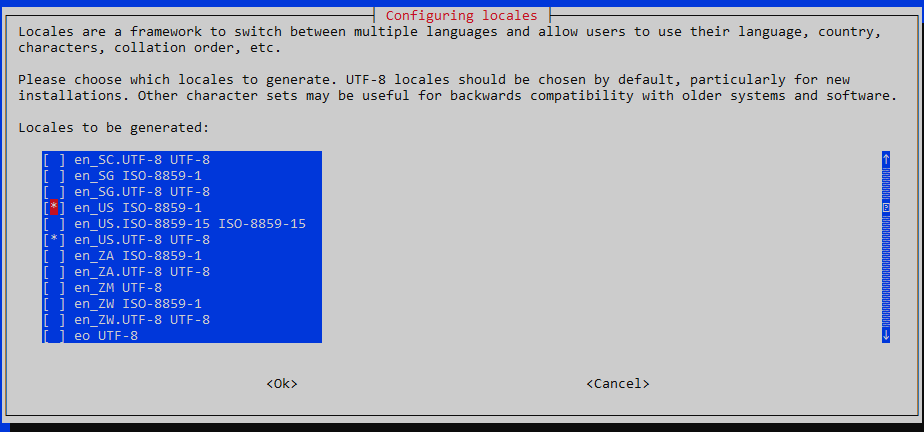

sudo dpkg-reconfigure locales

You probably want ISO-8859-1

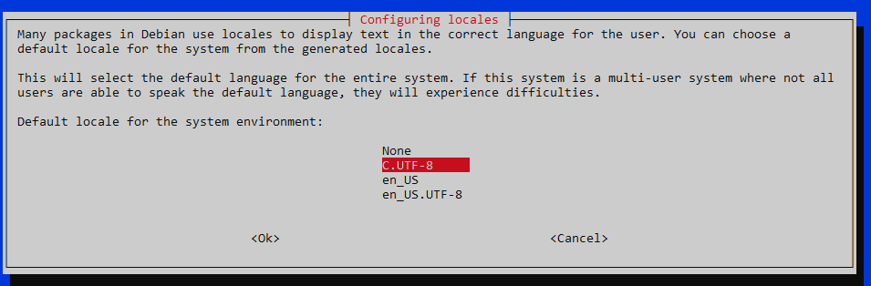

I tried setting that to the ISO-8859-1 setting and it doesn't seem to work even after logging out/in again. It doesn't look like it took even though it's been selected
Making the change on the selection screen
Trying to commit this to the system and it doesn't show the ISO-8859-1 option here
UTF-8 is preferred.
