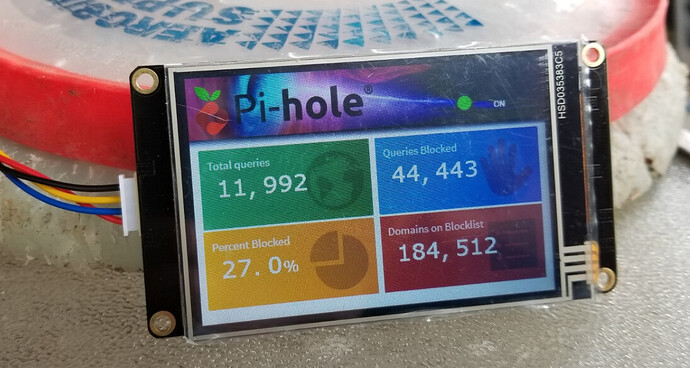

stand-alone unit which makes an http request to the Pi-Hole API service to grab current statistics. ArduinoJSON is used to parse the JSON request to grab the specific values of each field.

  • ESP32
  • Nextion Display
  • Pi-Hole w/ API service enabled

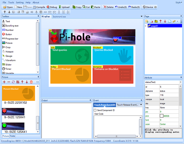

The Nextion display has it's own processor and memory, and images/text/functions are controlled via a simple serial interface at 9600 baud.
Let's say there is a textbox on the Nextion named 'status'. From the ESP, we can send a command over the serial interface to the Nextion display to change the text of that status textbox with the following command.
status.txt="hello world!"
Super simple! Can even upload images to the display, and use those images as the background for text boxes. This is the basic of this project.

The main thing I wanted was something to tell me if the service was enabled or not, as sometimes I do disable the Pi-Hole for work.
An easy IF statement takes the parsed JSON data, and if 'status' = enabled, then a green indicator is shown with the text 'on'. Else, show a red indicator is shown.
