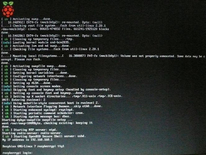

You can also shut down the Pi, remove the SD card, mount it on a computer desktop and create an empty file named ssh in the boot directory. Then eject the card, reinstall it in the Pi and boot the Pi. Now ssh will be enabled on the Pi and you won't need to hook up any hardware to the Pi.
