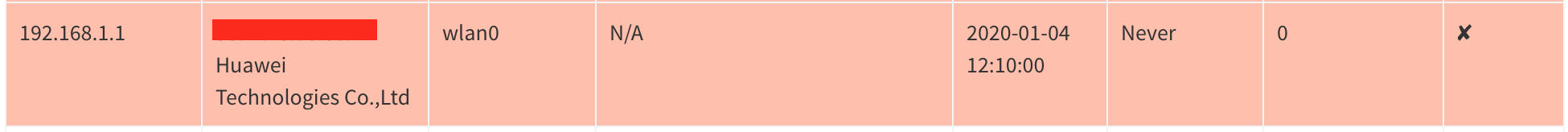

Pi Hole showing my router IP as client as well as devices IPs

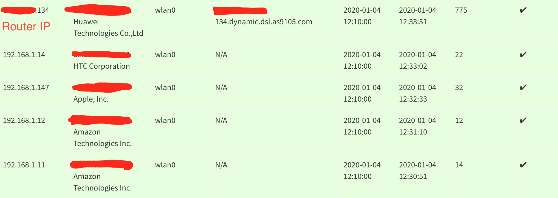

I'm having a strange issue where my Router WAN IP is showing as a client in the Pi Hole dashboard. It's not the usual issue where it only shows the Router IP for all requests, in my case it does show all my devices IPs individually AND my router IP, see below:
https://imgur.com/RpJttlO
If I go to the IP shown on the list in my browser I get my router dashboard screen that I'd normally get when visiting the local router IP.
Is this normal? Further down I can see my router local IP not going through Pi Hole which is what I would expect:
https://imgur.com/ZkbI5Hl
I have my Pi Hole setup with a static IP and set it up in my router as the DNS, DCHP is enabled in my router and disabled on Pi Hole. I have my Raspberry Pi connected via Wifi to my router (A+ model so no eth port)
Everything works fine as far as I can tell, I'm just getting a bunch of requests coming from this client that I don't think should be going through Pi Hole.
Pi Hole dashboard should only display the IPs of the clients connected to it.
Pi Hole dashboard displays both client IPs and router IP.

Thanks for your comments, now that I have a better look at it some of the requests showing up in the log as the router are coming from real devices, for example if I go to pi-hole.net on my laptop sometimes it'll show with my router IP in the logs and sometimes it'll show the actual device IP.

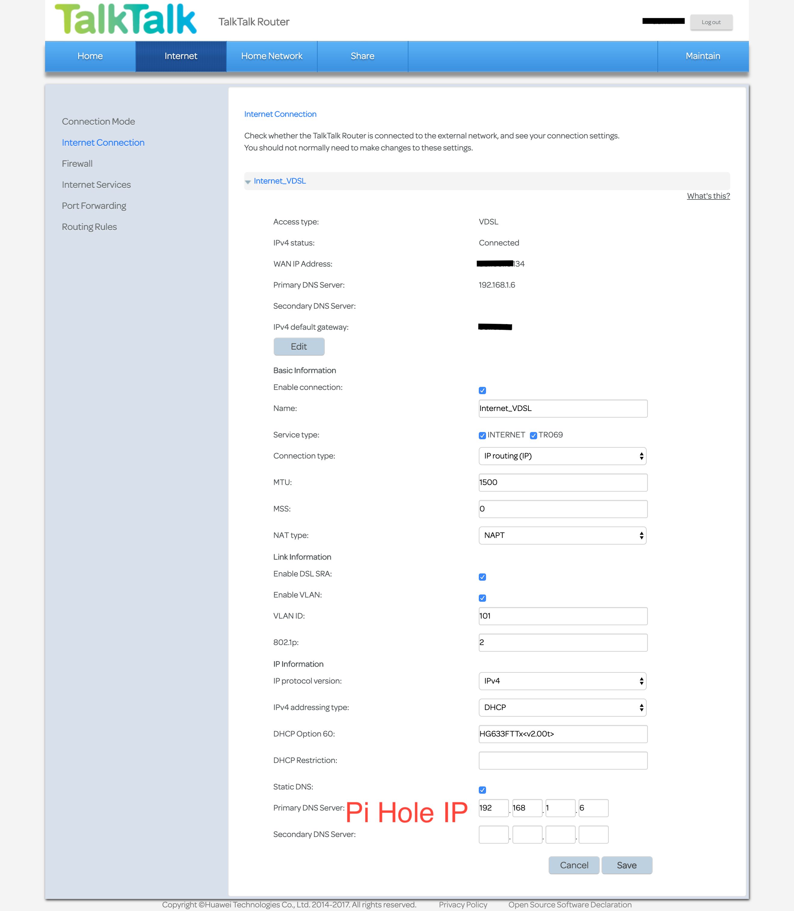

Well there's 2 places where I set it up, my router is a Huawei HG633 btw:
https://imgur.com/ckpXl02
And here:
https://imgur.com/a/Uz1KSe1
No, just the one wifi router / modem from my ISP.
You have configured your router to issue Pi-hole both as
  1. local DNS server to be used by its DHCP clients (through your router's DHCP panel)
    as well as
  2. the router's upstream DNS server (through your router's Internet_VDSL panel)
Strictly speaking - as your router supports it - only option 1. would be required to make Pi-hole resolving DNS queries on your local network.
But as you see quite a few queries in Pi-hole's Query Log that seem to originate from your router, it seems like
a.) your router is still receiving DNS queries from your network clients that it passes on to its upsteam DNS, or
b.) your router issues these queries all by itself
Option b.) would imply that you only see router related domains being queried, i.e. no youtube or google searches, but rather only requests to Huawei sites, time servers and the like.
Option a.) could happen if your router offers at least two WLAN networks, often a home and a guest network, where the guest network auto-configures the router as local DNS.
(The same could be true for a WLAN repeater forwarding requests to your router, but you have ruled that one out - no repeaters on your net - or if your laptop would connect to home net via Ethernet and to guest net via WLAN, which you also ruled out).
Option a.) also would occur if you setup and enabled Pi-hole only recently. Your router might advertise the new Pi-hole DNS only on lease expiration, which your screenshot shows to be happening after a day currently.
At the moment, this seems the most likely explanation.for your observation.
Once the 24 hour lease duration expires, your devices will finally get to know Pi-hole for sure. Note that DNS filtering by Pi-hole still might lag behind, as your devices might still cache responses to previous DNS queries that were not answered by Pi-hole.
You could enforce lease renewal by switching off or disconnecting a device, or by a router reboot.
