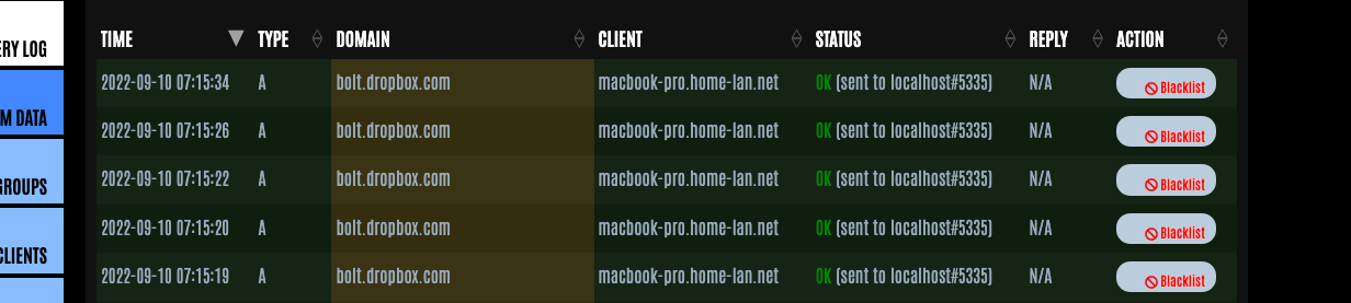

When I look at the query log via the web UI, I see the entry "forwarded to localhost#5335" so I know that part is working but I never see an entry saying "OK (cached)" which I would expect if it gets a good answer.

I noticed that I never see the port 5335 packet even though it shows up in the pi-hole query log
I am wondering if there should be an entry in the pi-hole's iptables to allow for the port 5335 traffic? Currently there is none just entries for port 53:

The other odd thing is that if I manually lookup something via dig pointing to unbound, it works!
pi@inet-pi:~$ dig @127.0.0.1 -p5335 www.google.com
; <<>> DiG 9.16.27-Debian <<>> @127.0.0.1 -p5335 www.google.com
; (1 server found)
;; ->>HEADER<<- opcode: QUERY, status: NOERROR, id: 50429
;www.google.com.			IN	A
www.google.com.		300	IN	A	142.250.73.228
;; Query time: 39 msec
;; WHEN: Sat Sep 10 07:48:20 EDT 2022
;; MSG SIZE  rcvd: 59
So I'm still confused but convinced it's something on the pi and not in my network.
